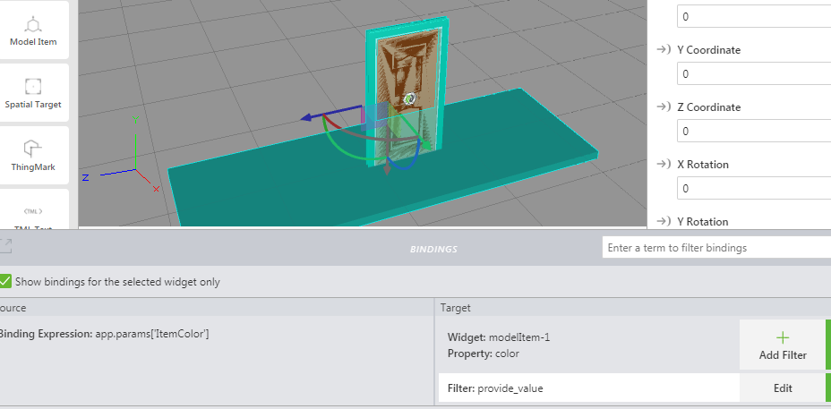

What I want to do is to have a button, which when clicked changes the part color during the experience.
I have applied model item widget to the part for which I want the color to change. given the desired color . Placed a toggle button and binded it to the model item color property.  But in the preview it doesn't work.
Alos, I followed the steps in the Article - CS251748 ​and still couldn't achieve my goal .
Kindly assist.

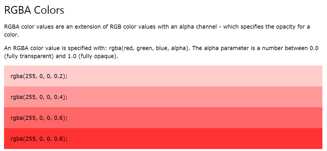

HERE the binding of the parameter has an filter defined as return 'rgba(' + value+ ',0,0,0.4);'; - which means it is the value of the paramter
So far I know it could has a value of 0-240 if we follow the user interface
2.)parameter is binded to the value of the Model Item property
So when we change the now the slider from 0-240 value it will change the red color
So back to your question in your case the click of your button should change for example the value of the parameter
app.params['ItemColor']between value of 1 and 0
in this case you can define a filter  e.g.:
if(value ==1)
return 'rgba(240,0,0,0.5);';
else
return 'rgba(0,0,240,0.3);';
This will change  the color depending of this if the button is clicked or not

Thank You very much. It's working know.
I was missing out the "Filter" part
