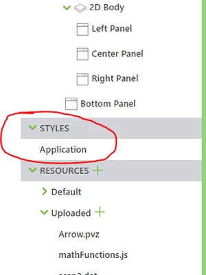

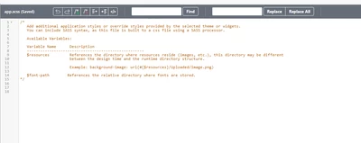

Jul 12, 2023 2:27 PM UTC
Hi, I tried to change the style within the app-theme.css file but the app-theme.css file reset all changes to the original settings and never saves my changes.
Every time I restart the Vuforia Studio project it resets the app-theme.css file to original fonts and etc.
How do you change the CSS ?
Jul 12, 2023 2:30 PM UTC
You don't need to edit any file in the project folder. You can just click on the "Styles --> Application" menu in Vuforia Studio.
There you can write CSS code.
