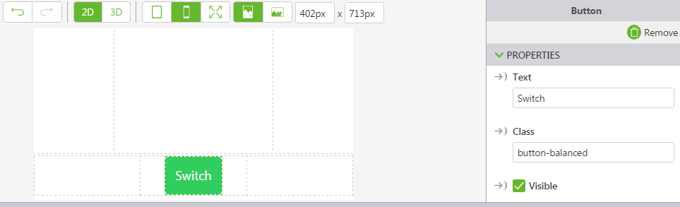

You can change the color both statically and dynamically in ThingWorx Studio. For static (i.e., stable throughout the experience), you can either write a custom css (under Styles-> Application) or you can use ionic framework classes to auto-define styles, please follow the ionic framework reference doc.​ As shown below, I was using button class 'button-balanced' to change the background as green.

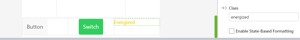

Here, I'm using 'energized' class on a label to change the color of text.
