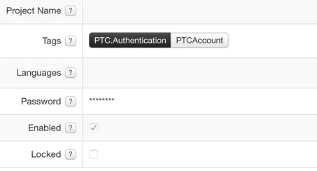

It also says the following:
I also don't have an admin account or anything else. I just logged in with my ptc trial account data...
DanielPi1-VisitorAuthorAnswer
Feb 12, 2019 7:51 PM UTC
I actually found an answer!
Since 2018 the instances were changed and Trial-Accounts don't have Admin-Rights anymore. For the Tutorials there are pre-created Things and Thing-Templates and an Application-Key as well. For the Raspberry Pi Tutorial it is necessary to use quotation marks for the "Thing(xxxx)" as seen within the image below:
