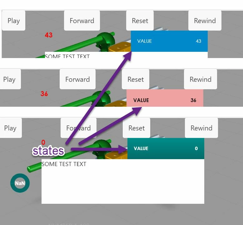

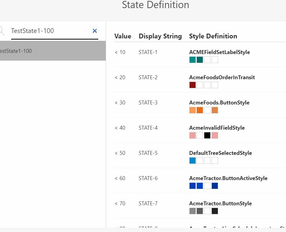

In Studio we can also used a Thingworx State definition.
Depending on the value of particular Thingworx Thing property  the state will change the apearance of a value
Here in the example the value of Value Display widget is the dependent Field. Means this what is used to decide which state from the thingworx stated defintion is used for the display of the widget
Here is a sample definition for a Style definition :

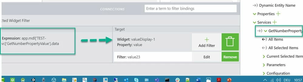

Hi @vieirac1 ,
one possible option is to use some state base filter - where you bind the value to e.g. application parameter and then used the techniques described in the post :"Using Connection Filters for state-based rendering and value formatting"
