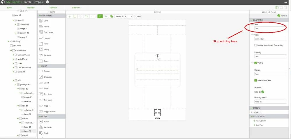

Changing text in label widget from home.js
As the topic is named I want to change the text in the a 2D-widget not by writing in the label field in properties window, as seen in the picture but rather I would like to change it in the home.js script.
I was thinking of writing a code like this:
$scope.app.view.Home.wdg['label-59'].text = 'hello';
OR:
$scope.setWidgetProp( "label-59", "text", 'hello');
Tried different variations, but none of them seemed to work.
I must miss something, does anyone have any suggestions?

Hi @PhilipB,
may be, a significant question could be , when do you want to call this function.  You can call it from a button as mentioned by @tmccombie . This should always work.
But when you try to set property on start , when you load first time the project - view - in this case if you write simple :
 very probably this will not work because the object /widget is not initialized yet.
So the first idea is to call it with some timeout /delay  like:
$timeout($scope.setWidgetProp( "label-59", "text", 'hello'),4000) //4 sec
And when use  enough large value of delay this will work at the end , but this is also not a good solution.
The recommend way  will be to use an event where you know that when this event is fired,  all object are already initialized.
So if you want to set a 2d widget then you can use  $ionicView.afterEnter', event  - example:
$scope.$on('$ionicView.afterEnter', function() {
But this will not work for a 3d widget. In this case you need to use the modelLoaded  event - example:
$rootScope.$on('modelLoaded', function()

PhilipB1-VisitorAuthor
Nov 19, 2019 2:22 PM UTC
Allright I see!,
Thanks for the reply @tmccombie and @RolandRaytchev! Of course I need something to "trigger" it to start working. I tried all variations and it all worked but I wanted to initiate the function at start so the last method worked best with:
Thanks for again!
