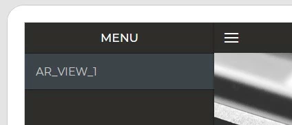

I would like to change the background colour of the side menu items after I've clicked them.  The screenshot below shows the colour I would like to change.
Is it pseudo element or class that I need to apply CSS?

you can change this color by changing the .item.activated class:
For example:
.item.activated {
background-color: red;

micah1-VisitorAuthor
Apr 2, 2020 8:32 PM UTC
The menu was created by adding another view. It doesn't appear in the tree, so I'm unable to add a class or click event to it.
Apr 3, 2020 7:25 AM UTC
I'm not sure if I understand you right...
But you should be able to see the tree of the added view when you click on the view first.
Can you add screenshot of you studio editor or even better the project? Then we can figure it out for sure.
Thanks.
