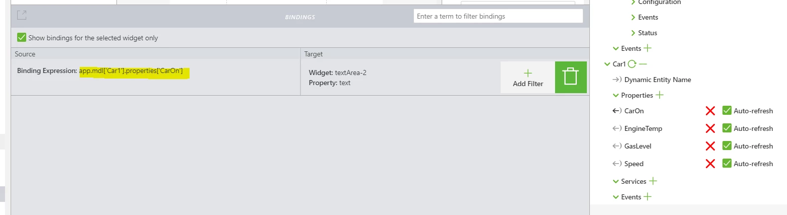

From an AR experience (Vuforia), I want to change a Thing property (in Thingworx) only if a condition is attended. The problem is I have no idea about how the syntax is.
For example:
In Vuforia Studio > Home.js:
if(waterTemperature == 50)
[change a thing property from false to true];
I assume it would be something like "$scope.thing[ThingName].propertyvalue = true", right?
Thanks!! 🙂

@rgomes  You a Car1 thing example having property CarOn you can use the JS code as -
$scope.app.mdl['Car1'].properties['CarOn'] == "Some Value or logic"
Please refer to attachment. Also as an easy way to get required detail, you can bind the  ThingWorx entity using external data in Studio to an input text of widget then refer to Binding Expression for details.

Wow, how haven't I seen it on the binding details as you've shown?? Smiley Indifferent I'm still a newbie, after all!
