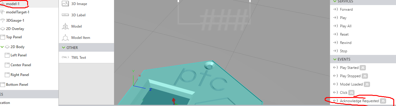

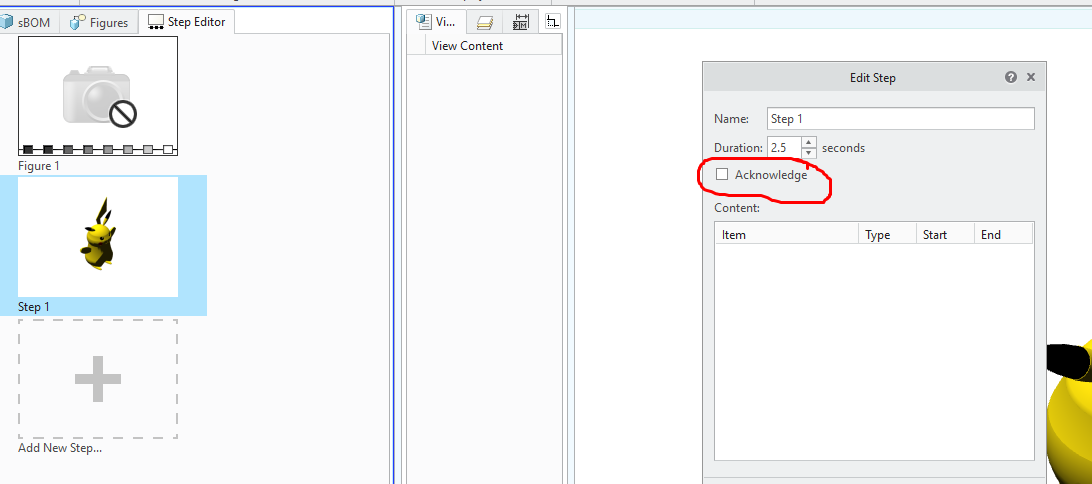

January 25, 2018
Sure,
One way would be to create the sequence in creo illustrate - and there request validation for the last step.
This will trigger a function that you can reuse in studio e.g. to show a popup or do something else with it.
Martin

January 25, 2018
Hi Martin,
thanks for your help.
Now it's easier to understand when the animation is over
