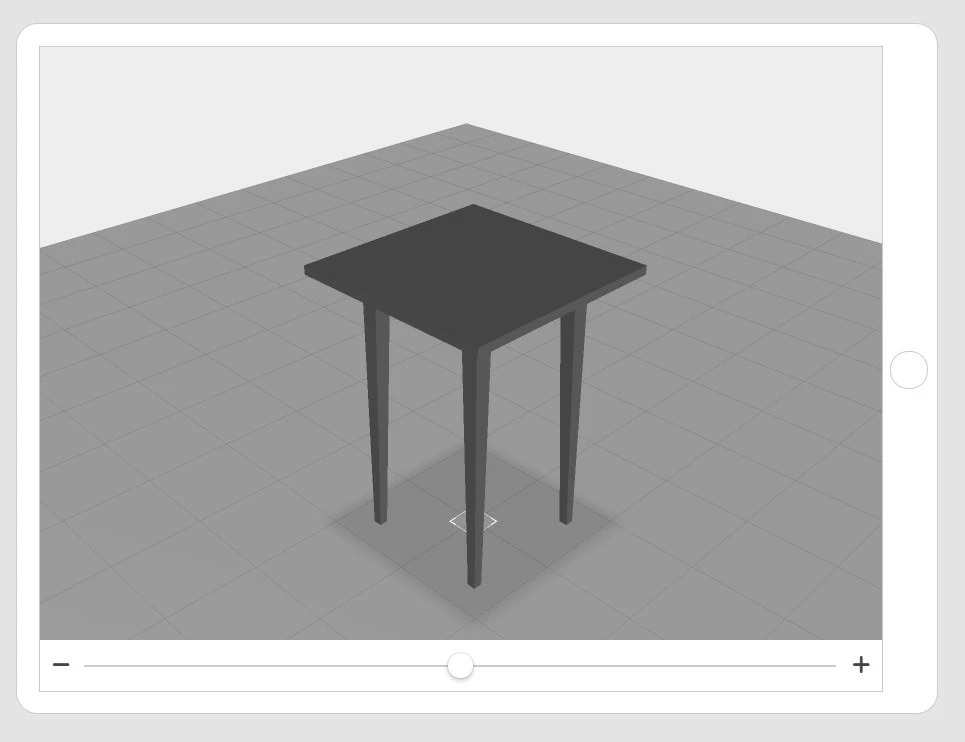

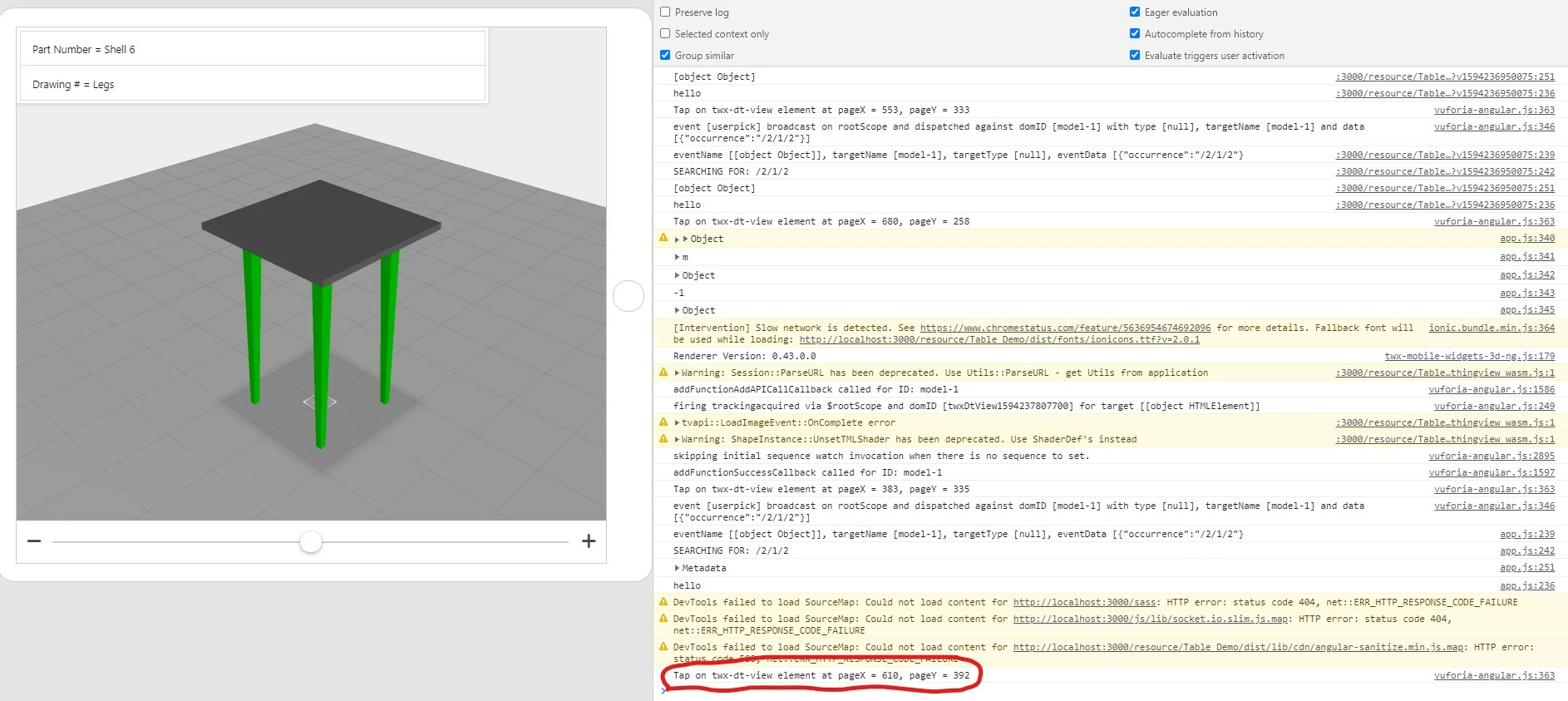

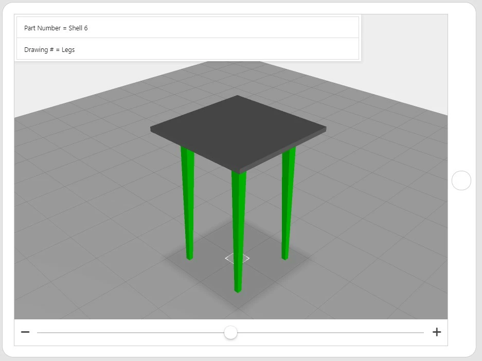

I have a $scope.$on('userpick', function(evtName, targetName, targetType, evtData) {} tracking when a widget is selected to perform the highlight of the occurrence and show the name of the part and next parent occurence or asssembly in a popup. But it seems as though the userpick is only for when an item is clicked/touched. The only thing that I have seen in my developer tool for console that is enacted when a click/touch is not on any widget within the experience is that it shows the coordinates of the pixels for the device where it was touched under the the clickhandler function within the vuforia-angluar.js
You can see the images I have attached is that the "Starting" shows how the experience loads. "Clicked" shows when one of the legs is selected, it highlights, and shows the popup with data. "Console" file shows when I click within the window of the device but not on the model widget, the circled line is the only indication for clicking there.
