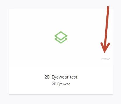

'Connection Error' message when scanning a ThingMark
"Unable to connect to an Experience Server. Check your settings or contact you Administrator."
I am using Vuforia View on a Vuzix M300. I have published the demo app and am trying to run it by scanning the ThingMark, but receive this message. The Vuzix is connected to Wifi, I have set up the Experience Service with the default address in the project and matched it in the View app by scanning the QR Code. When I try to scan the ThingMark in the 'Publishing an AR Experience' help bar on the right side of the screen, I receive this message. I am using a trial of Vuforia Studio. Anyone know how to resolve this issue?

Jul 4, 2018 9:51 AM UTC
I have attached the screenshot instead displayed it inside my post.
Yes, you have right.
3D eyesware projects are only compatible with Hololens.
So, it is needed to create a new Project specific for your device.

Jul 4, 2018 9:39 AM UTC
So, the Experience Service is accessible.
The issue doesn't seem to come from WIFI network.
In Vuforia Studio, in the Home page, what is the icon on your Project ?
In this screenshot, we can see the icon of an 2D eyewear project.
This kind of Project is compatible with Vuzix M300.
