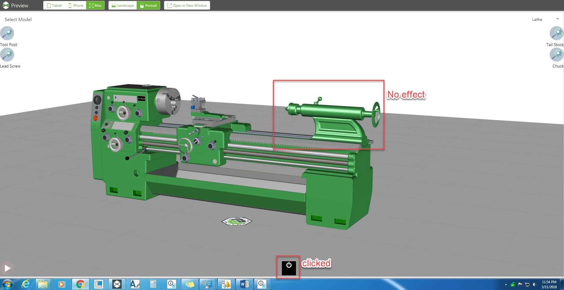

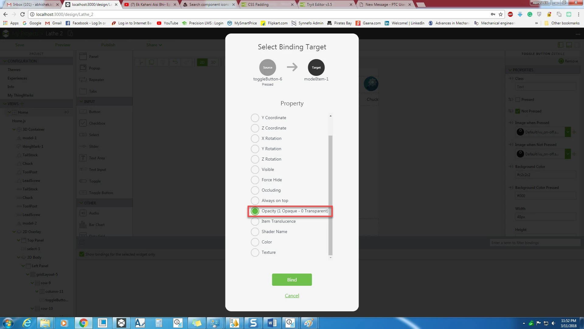

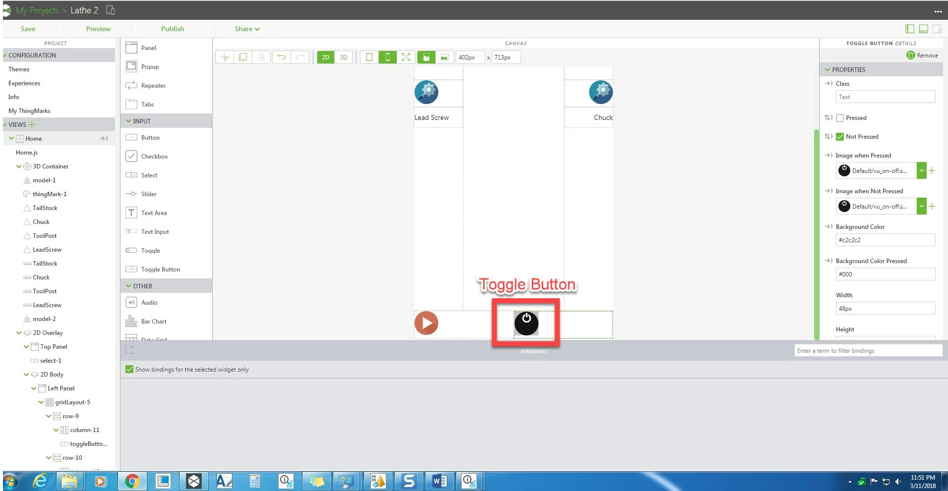

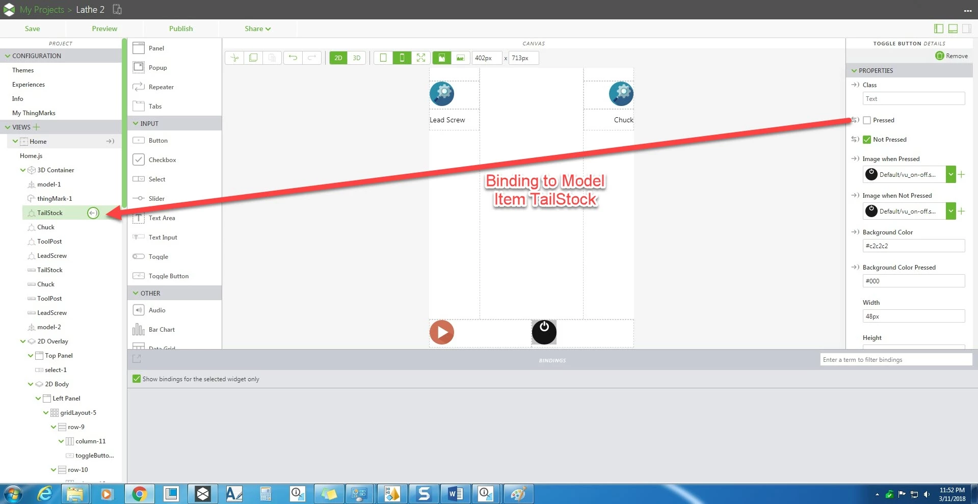

I want to decrease the opacity of a model item by half on clicking a toggle button. I am attching screenshots of my approach to doing it.
I am unable to do it.
Kindly tell me where I am going wrong.

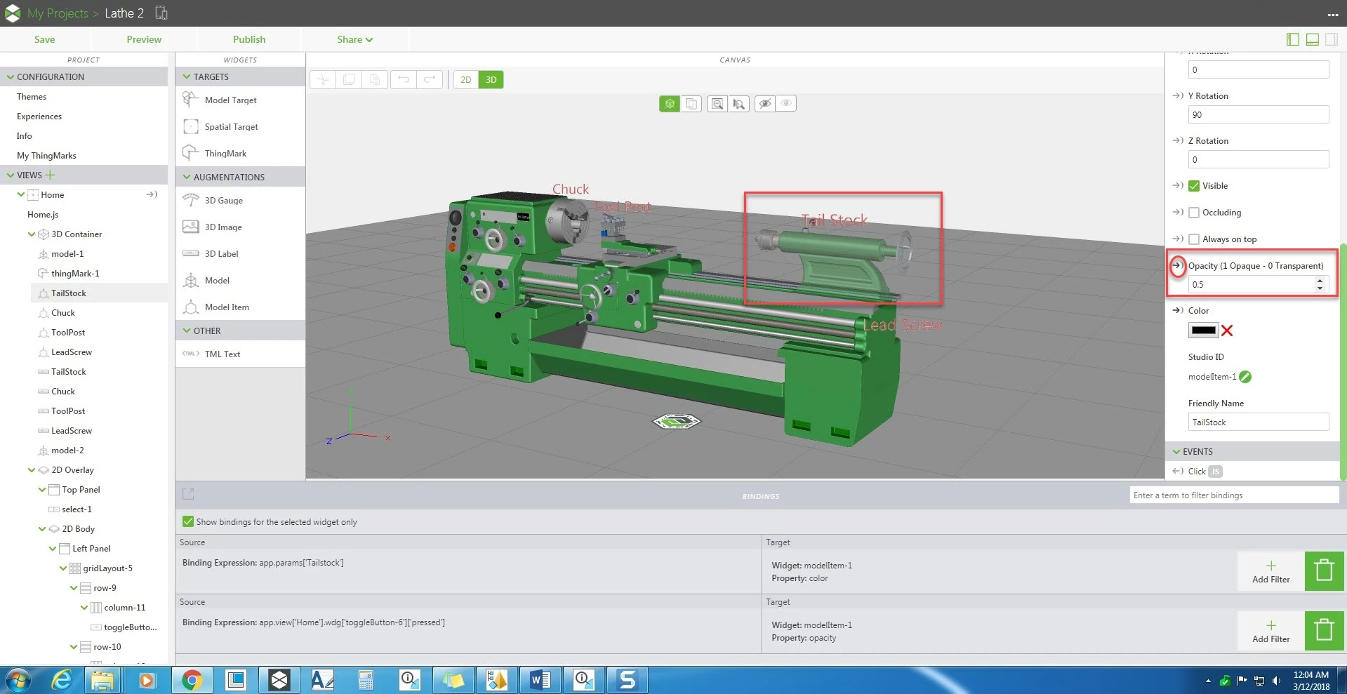

You would need to tie the 'pressed' event to the opacity of the model-item. You can use an application parameter and a simple javascript function to achieve this.
I ran a small test to confirm this would work. I created an app parameter called 'OpacityMI' and bound it to the model item opacity. in Home.JS I added this function:
$scope.changeOpacity = function(){
 $scope.app.params.OpacityMI = .5;
I then called this function on the 'Pressed' event for the toggle button and was able to see the opacity change.
