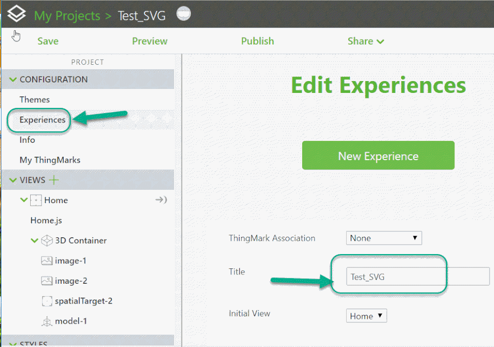

Copying an existing experience and giving it a new name does not change the name in the json metadata, so when you view both the duplicate and the original in the experience server, they have the same name. This leads to confusion of course.
To recreate this glitch:
  1. Create a new experience in Vuforia Studio (TEST-123)
  2. Publish to your Experience Server
  3. Go back to Vuforia Studio & click Save As --> Give the duplicate a new name (DUPLICATE-123)
  4. Publish this duplicate
  5. Turn on your HoloLens Vuforia View app. --> "Hey View", "Show Library"
  6. The library will show two experiences with identical names: TEST-123 & TEST-123

Hi @Wes_Tomer ,
I think (did not test it) that to have different names you need before step 4.)  to change the title of the duplicate experience:
and then step 4.)
