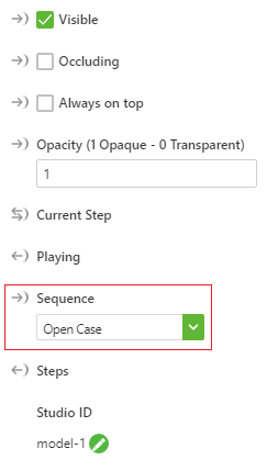

I am trying to create a training with thingworx studio for AR/VR. But I can only select one sequence. I would like to advance to the next step only after giving a voice command or a gesture.
How to add multiple steps in thingworx studio? Should the Steps or Sequence be binded?

This is what you need to do.
  1. You need to change the pvz to zip,
  2. Remove the *.pvi files, rename the zip back to pvz and copy the pvi to the Uploaded resource file  or upload them
In Javascript , reference each pvi by function
$scope.yourFunctionNamePVI1 = function() {
$scope.view.wdg['model-1']['sequence'] = 'app/resources/Uploaded/[yourpvi]';
  $timeout(function() {
    $scope.$broadcast('app.view["Home"].wdg["model-1"].svc.play');
    $scope.$applyAsync()
           , 2000);
$scope.yourFunctionNamePVI2 = function() {
$scope.view.wdg['model-1']['sequence'] = 'app/resources/Uploaded/[yourpvi2]';
           , 2000);
Now you can gesture or click and execute the function to play your sequence of your choice.
You do not need to choose a default PVI for model

thank you, that worked
