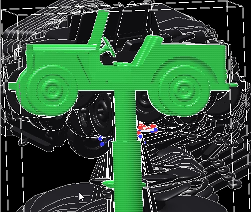

Creo Illustrate graphics distortion
All models in Creo Illustrate show a trail and graphic distortion when they´re moved around.
May 29, 2019 7:33 PM UTC
solution was to add a System Variable:
Variable: PV_DISABLE_MULTISAMPLE
Value: true
AlanCazares1-VisitorAuthorAnswer
Value: true
