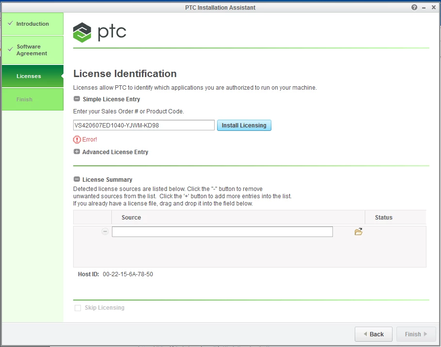

Creo Illustrate Installation: License issue
I used "VS420607ED1040-YJWM-KD98" as described in "Getting Started with Vuforia studio", chapter 4, point 4, page 27 for licensing Creo Illustrate. But I received the following message: !Error!. I repeated it several times. the result is the same. Help me! How can I license my Creo Illustrate?
AsiyaAnswer
Jul 9, 2018 11:43 AM UTC
I found the solution: I installed requested in update KB2999226 for Universal C Runtime. After update I can use license process properly.

Jul 6, 2018 5:37 PM UTC
When you select "Install Licensing" are you getting a pop up that requests credentials? If so, are you using your ptc.com account login information?
Asiya1-VisitorAuthor
Jul 9, 2018 7:03 AM UTC
Yes, I used my used my ptc.com account.
Asiya1-VisitorAuthorAnswer

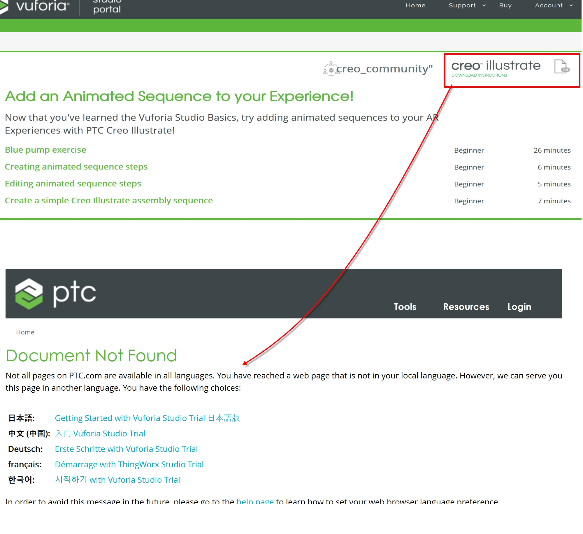

Jul 14, 2018 2:22 AM UTC
Hi @Asiya
Could you please provide me with link to download Creo Illustrate, I'm trying to download it from my studio portal but it says document not found. I'm desperate to get started with it as I have a use case to build but cannot find the download link to Illustrate anywhere.
Any help is much appreciated

Jul 25, 2018 3:45 AM UTC
Hi @Asiya ,
Thanks fro your response and apologies for the delayed reply. we have been trying to solve this mystery of downloading Creo Illustrate.
As you mentioned, We tried to navigate to the Getting Started Guide(PDF) from Studio's home page. But it just goes to the document not found page. Please see the screenshot below and in my first post. Any Ideas around this? Also, do you have a subscription to Vuforio Studio or you are using a trial license?
Thanks.

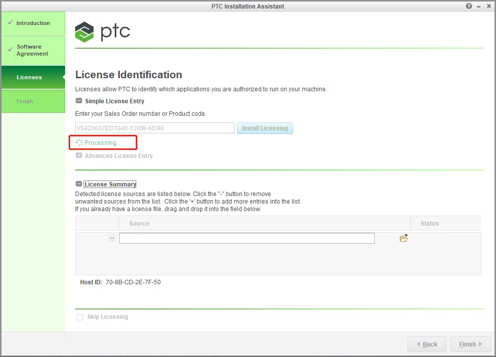

Dec 10, 2018 7:57 AM UTC
Hi, I run into this issue as well. However I am not getting the "error" msg, I was stuck at a "Processing..." msg for more than a hour and nothing happens.
Any one know what is going on? Thanks
