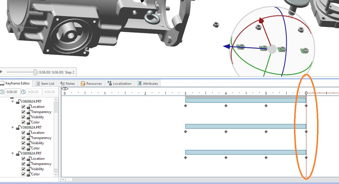

I am creating a sequence to use in Vuforia Studio. I selected 4 parts and moved them up, then across, then down. Each movement created a new keyframe for every selected part. I want to remove the last movement. Do I need to manually expand the track, find the part, expand it, find the keyframe, then select and delete it - for every individual part - or is there a way to do this for all of the parts in the track at once?

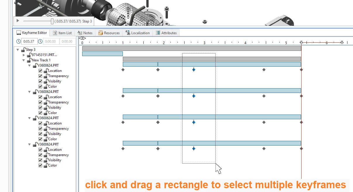

I figured one solution out -- expand each item in the "New Track" and then click and drag to select multiple keyframes (see attached)
