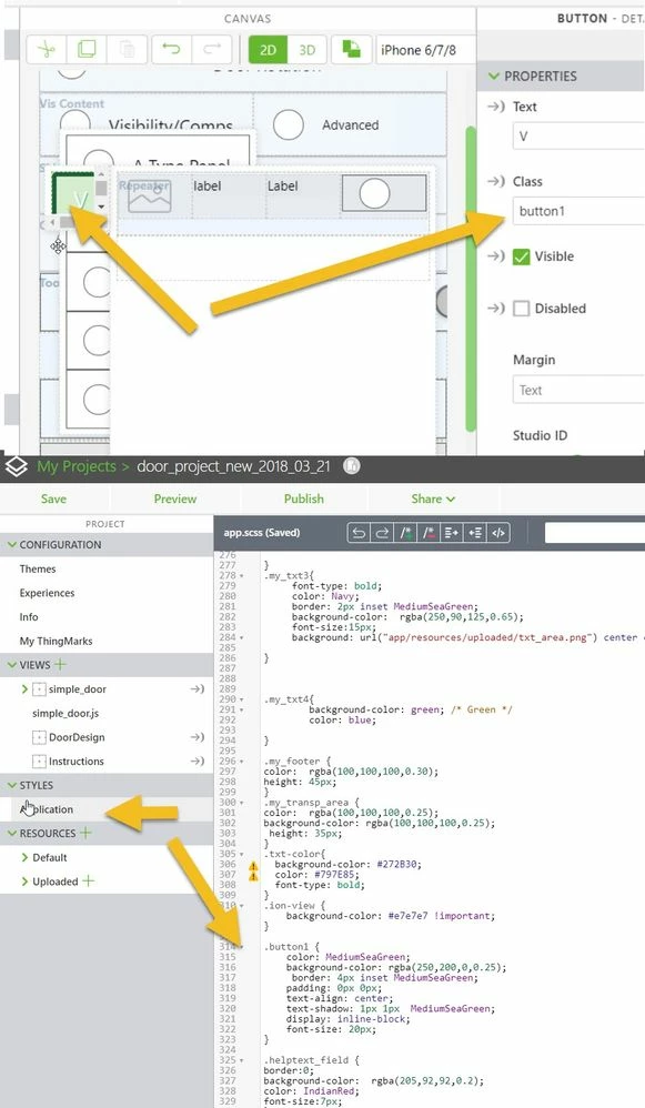

The most 2d widgets  (e.g. button) support the class property.  In this property you set the behavior via CSS class
To enter CSS code in your experience, on the Project pain, expand the Styles option and select Application. This will open up an editor view where you can enter the CSS code for your experience. CSS changes can be seen/tested in the Studio Preview.
In generally the most css definition should work there but you need to test in preview and on the desired mobile device if this really work
