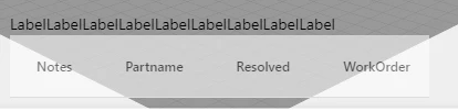

I have a Data Grid widget that does not appear to be working. I have a datatable from Thingworx with a service bound to a data grid widget but the data is not showing up. My thingworx connection is working and I am getting successful "service invoke complete". The service returns data in thingworx and in vuforia by other widgets/console log.  The only issue is the data grid widget.

I just tested a project where I used this widget and have similar issue. I will check it further and will report this to PTC R&D Team. Thanks
April 17, 2023
I was able to reproduce the problem with new project  so reported the problem to PTC R&D team as Jira VTS-1469. I will provide here an info /update when there is a feedback from dev team. Thanks
April 20, 2023
so PTC development team did reproduce the issue and is working now on fix, so possibly solution in release next or in 2 months because issue seems not be trivial. when I have further information I will share it further there. Thanks
May 3, 2023
so far I see fix should be released with Studio 9.11.1263.0 (2D Widget) and 9.11.0.1302 (3D Widget).
