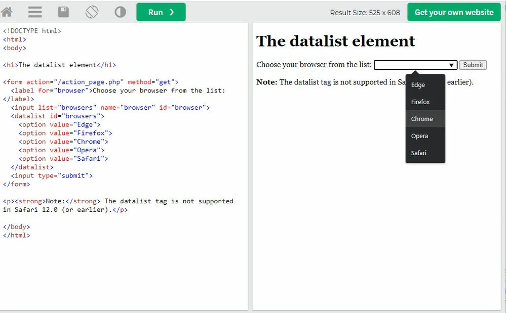

at the moment the widget select is for us insufficient and this why i try to create my own dropdown widget with the html tag datalist like this: https://www.w3schools.com/tags/tag_datalist.asp
It works on all browsers as intended and in the preview aswell - it works even on safari - but not in Vuforia View (version 9.11).

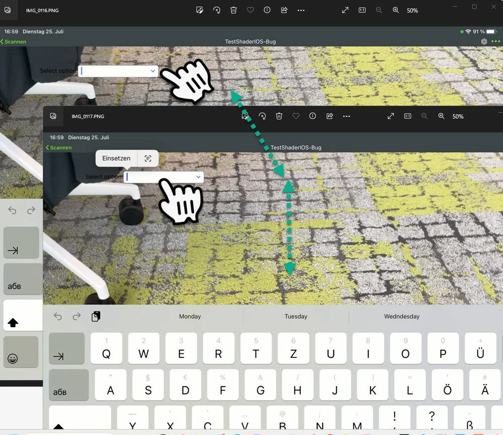

The opend dropdown menu is missing there and the options are given as suggestion above the keyboard input.

Datalist works on safari but not at Vuforia View. The entries will be only above the keyboard as suggestion and not as a dropdown.

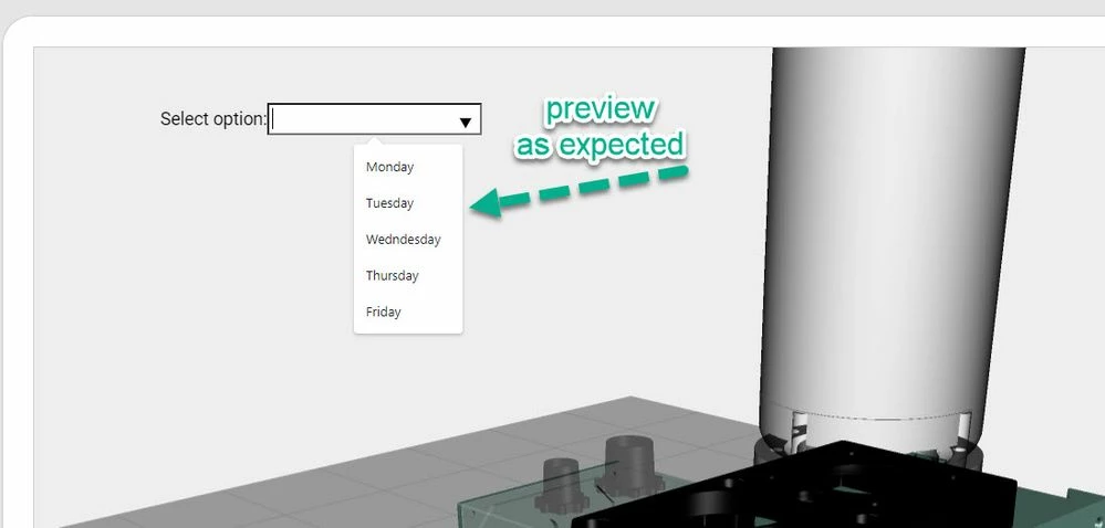

So tested with simple widget extension and have in preview:
on mobile it was working only partially:
so was able to select the data list and to input data via  the mobile virtual keyboard but I was not able to see the List Elements or to search. So I hope  that this the issue  what you wanted to report. If not then, please, let me know.
Reported it  to R&D as Jira Ticket VTS-1623 and if there is some feedback on it I will report it here further or somebody form R&D will provide here a feedback.   Thanks.
