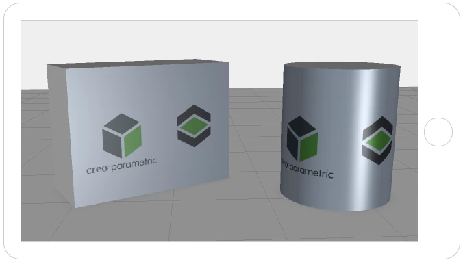

Could texture in Creo Parametric be a solution to this?
https://support.ptc.com/help/creo/creo_pma/r7.0/usascii/index.html#page/fundamentals%2Ffundamentals%2Ffund_four_sub%2FAbout_Textures.html%23
decals from CREO Parametric texturedecals from CREO Parametric texture
Decals set in CREO Parametric as Texture, then Save As PVZ.
Apr 6, 2021 8:15 AM UTC
It can be a solution but I only want to use Creo Illustrate because many of ours customers do not have Creo Parametric.
