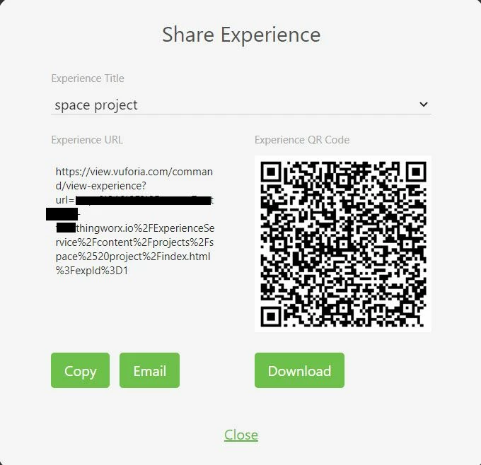

im trying to create QR codes to deeplink to experiences that have spaces in their project name, such as
'Sample Project'
If I urlencode the whole thing to something like
vuforiaview://ptc.com/command/view-experience?url=https%3A%2F%2Fvf-es.ptc.com%2FExperienceService%2Fcontent%2Fprojects%2FSample%20Project%2F
and build a QR code, the link is shown to be invalid.
Without the spaces, e.g. for a 'SampleProject', everythings fine.
Am I missing something here and is there a way to fix this?
Thank you so much

Hi @CS_9203536 ,
so seems that space is working also for qr code example:
https://view.vuforia.com/command/view-experience?url=https%3A%2F%2Fmyexperienceservice.studio.thingworx.io%2FExperienceService%2Fcontent%2Fprojects%2Fspace%2520project%2Findex.html%3FexpId%3D1
  So when you publish the project and then go the share button - it generates the deep link and also the qr code
So I used a project named   "space project" and it was encoded to "space%2520project"    so means that here in QR code is used for space %2520     the url decoder e.g. https://meyerweb.com/eric/tools/dencoder/ will suggest %20 which will not work there

no,  sorry if there is mistake in my post. The QR code generated by Vuforia Studio with a project having a space in the project name  seems to work. But other url encoder seem to use different syntax. And in this case if otherwise the QR code was generated in  this will not work
Is your issue occurring in Studio - means the QR code is created by the share tab ? In this case  which version of Studio was used?
I used Vuforia Studio 9.6 restricted installation where it was working
