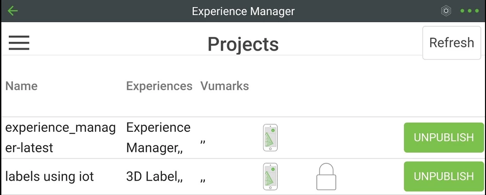

Aug 12, 2021 8:13 AM UTC
Hi newbie,
There is a tool Provided in the PTC Field Tech Enablement Vuforia Studio C2, I've copied out the page and attached the tool, you just import it in Studio and run the preview, but do not publish it because then other people can delete your experiences.
Cleanup Deployment Utility
Unpublishing each individual Project via Vuforia Studio can be a slow process.
A more effective approach is to use the Experience Manager utility  Professional-Studio_Experience_Manager.zip​
Using this utility helps keep the server tidy and uncluttered.
The Experience Manager can be run in Preview do not publish this experince . Below show the UI in Preview mode.​

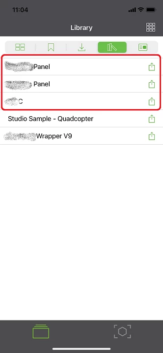

Aug 13, 2021 4:47 AM UTC
Hi  Alex,
I am back with more question 🙂 , I successfully deleted the files using the Experience Manager utility  see below, but .....
When use both mobile and ipad with the Vuforia view to browse the experience server, i saw 3 extra "experience" appearing in the Vuforia View?.
I clear the cache, delete, re-install the Vurforia View, yet the 3 extra experience appear? Can advise me where else i can check to remove the 3 extra experience in the Vuforia View. ( The \ptc\studio-es-store\projects does not contain these project. ) Hope you can advise.

Aug 13, 2021 7:52 AM UTC
Hi Newbie,
Sadly, I cannot answer those questions, maybe someone with more experience can help you there.
Good luck!
