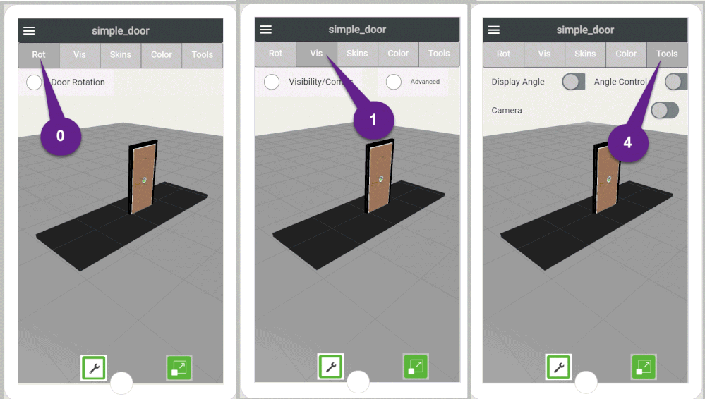

so I will suppose that you have the following situation :
We have here 5 different tabs with index 0-4
But the name could differ.

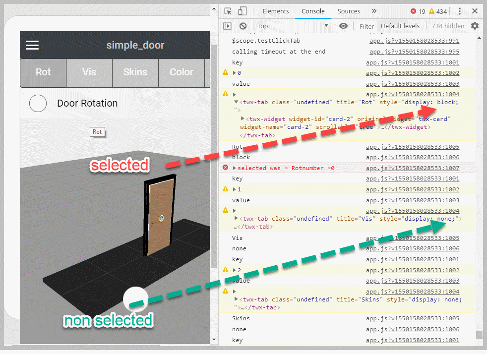

then check on the chrome console in debug mode (Strg-Shift-I)

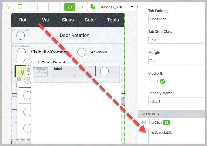

So, to check it further used Tab click event to call some code like this:

And now  test the code  for the TAB widget:

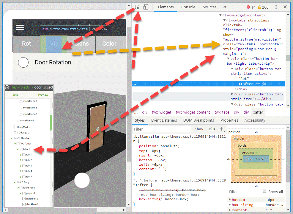

So when we test this code and check the warn printing in the console - in this case we can find a little more about the twx-tab properties:
So now the code could be changed to :
$scope.testClickTab=function() {
 angular.forEach(
 $element.find('twx-tab'), function(value, key) {
 console.log(value['title']);
 console.log(value['style']['display']);
 if(value['style']['display']=='block') console.error("selected was = " +value['title'] + "::number =" + key);

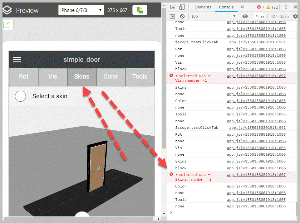

So now we can idetify the selection when a tab is selected:
So now we can identify the selection when a tab is selected:
So here the function $scope.testClickTab() is called when the tab is set /changed the value. So in this case you can set an application parameter which should track the current tab setting
... But you can call this function from any other widgets or events. It will check for all tabs in the current View - so if you have more then one Tab widgets it will find all tabs. So in this case you need additional to check the tab names to be sure which tabs was selected.
