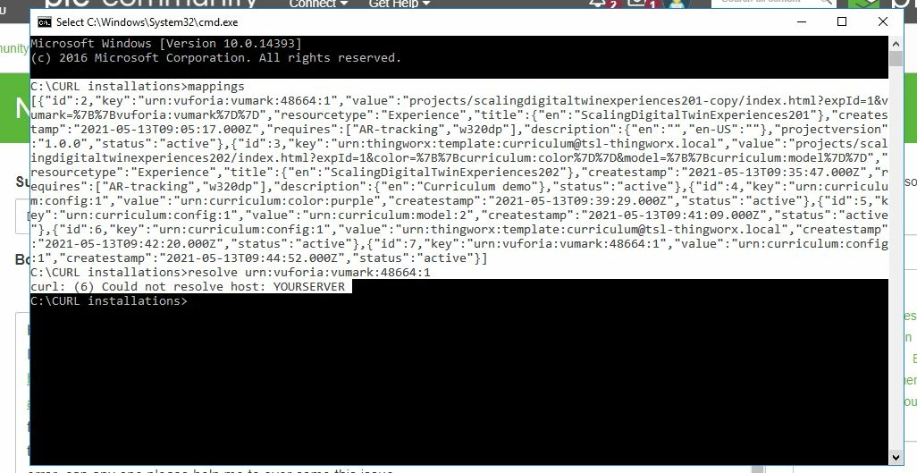

in that Configurations with the Identity Resolution Service (IRS) tutorial i followed every steps but at  last i am getting this "curl: (6) Could not resolve host: YOURSERVER" error in CMD prompt ,can any one please help me to over come this issue.

Unfortunately, you link isn't working for me. But looking at the error it looks to me like "YOURSERVER" is a value that has to be changed corresponding to the name / address of your server.
