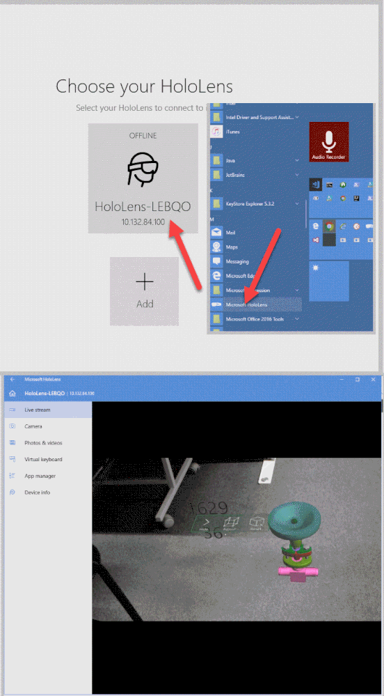

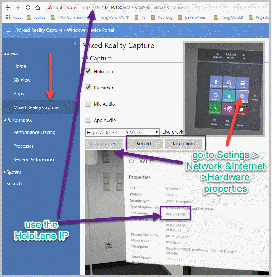

But if you just have a single HoloLens and you want to show the view that the user is seeing on a screen there's multiple ways to do this.
  1. Use the HoloLens App on a Windows 10 PC and connect it up to your HoloLens: https://www.microsoft.com/en-au/p/microsoft-hololens/9nblggh4qwnx
  2.  Connect to the HoloLens via the device portal and show the view that way: https://docs.microsoft.com/en-us/windows/mixed-reality/using-the-windows-device-portal
Some of this information is reference in the Studio Help pages about HoloLens: http://support.ptc.com/help/vuforia/studio/en/#page/Studio_Help_Center%2FEyewearBestPractices.html%23wwID0EFN1O
I regularly show the HoloLens view on my laptop screen by using the HoloLens App.  Then my laptop is connected to a project or big screen and everyone can see what I'm seeing.  It works pretty well, but there's usually a bit of lag.  It's always better to view the experience through the HoloLens as it will be in stereo 3D, so if I've got a smallish group, I'll show them how the experience works as I run through it and then they can put the HoloLens on and run through it themselves.

So here I want only to show some picuture to the mention above:
So above is shown how it works when we connect the browser to the HoloLens Device
Another way is to use in Windwos 10 App Store to downlaod the App "Microsoft Hololens". In this case it is more easy to handle the video record
