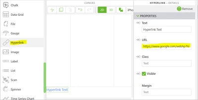

Hello @Aditya1702 ,
You can display a website using the Hyperlink widget and entering the URL as shown below:
Once you close the website(tab on back button), you will be back to the AR experience and you won't need to scan again

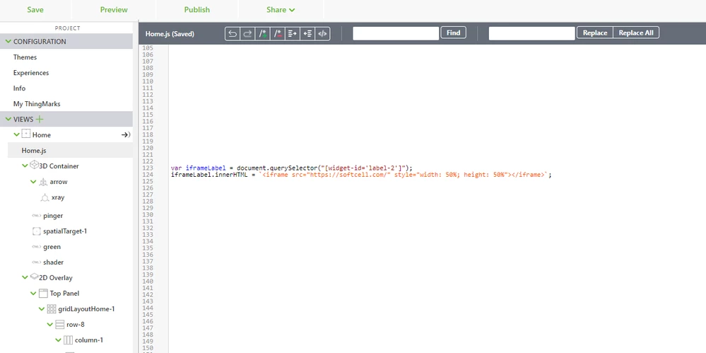

Hi Aditya,
there is a hacky way to add an iframe to a vuforia studio experience:
Add a 2D Label to your view.
Add the following code in your views javascript:
var iframeLabel = document.querySelector("[widget-id='label-1']");
iframeLabel.innerHTML = `<iframe src="https://example.com/" style="width: 100%; height: 100%"></iframe>`;
Replace "label-1" in the first line with the id of your 2d Label.
Replace "https://example.com/" with your websites url.
To hide the iframe you can simply remove the labels content:
iframeLabel.innerHTML = '';

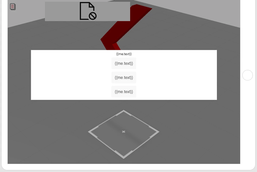

May 25, 2022 5:08 AM UTC
Hi @KS_9982057 ,
As suggested I tried the above method but it still didn't work, I may be doing it wrong way so below are the screenshots do guide me if I've done it in the wrong way.
Thanks in advance.
Aditya Gupta.

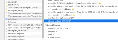

your website responds with a x-frame-option header, which is set to "sameorigin".
This disallows the embedding on a different domain. (See more on https://developer.mozilla.org/de/docs/Web/HTTP/Headers/X-Frame-Options)
The easiest solution would be to remove the header from the servers response.
