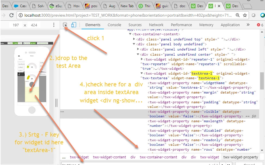

  • switch to preview mode
  • press Strg -Shift -I  keys to open the chrom debuging mode
  • follow the step according the picture below:2018-06-29_17-18-59.jpg

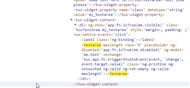

  • check of element with related object type name:2018-06-29_19-21-11.jpg
  • So now to set the text property of the textarea we can use some code like this:
    //find the element
    var textarea = angular.element(document.querySelector('twx-widget[widget-id=\"textArea-1\"] textarea'));
    //set the text value
    textarea[0].value="LLLLLLLAAAAAAAAAA";
    So hope helps!
