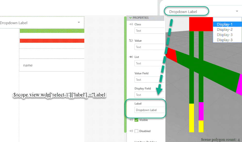

can i hide label?

"can i hide label?"
label from what / widget label or the select widget simple reset the label property:
$scope.view.wdg['select-1']['label'] ="Label value";
