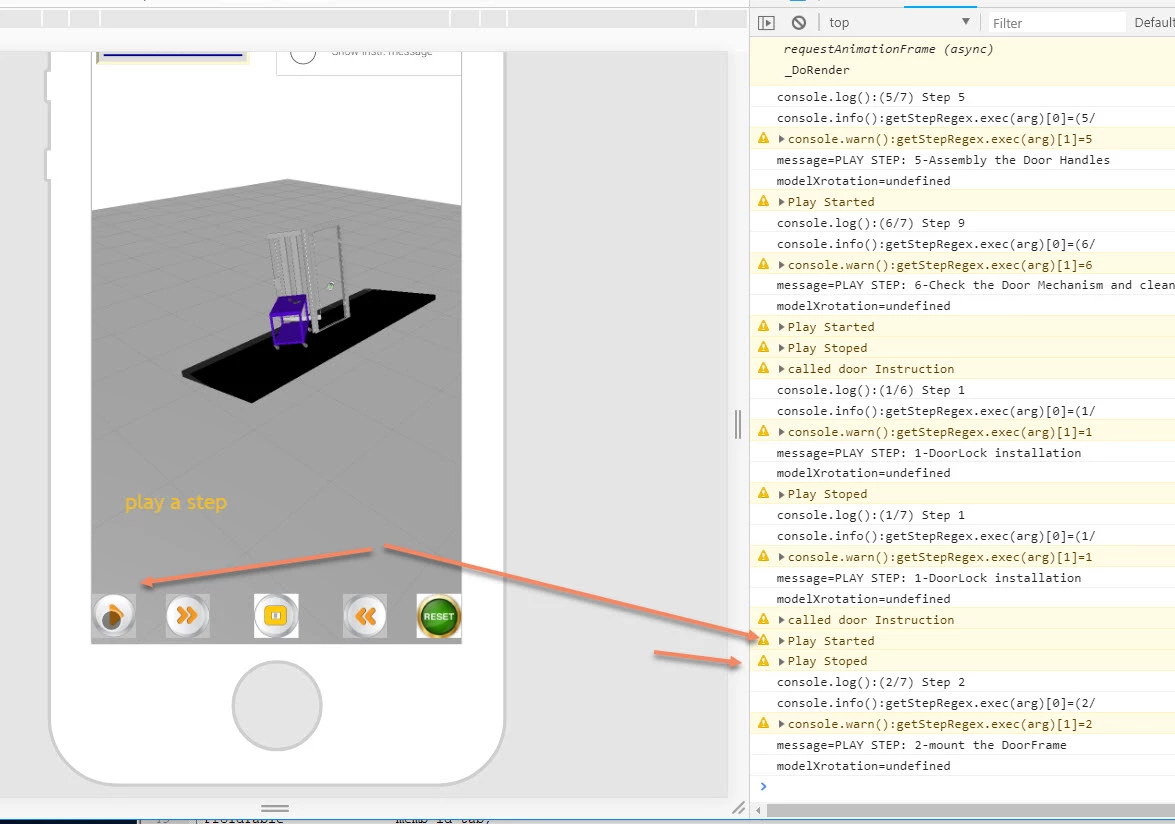

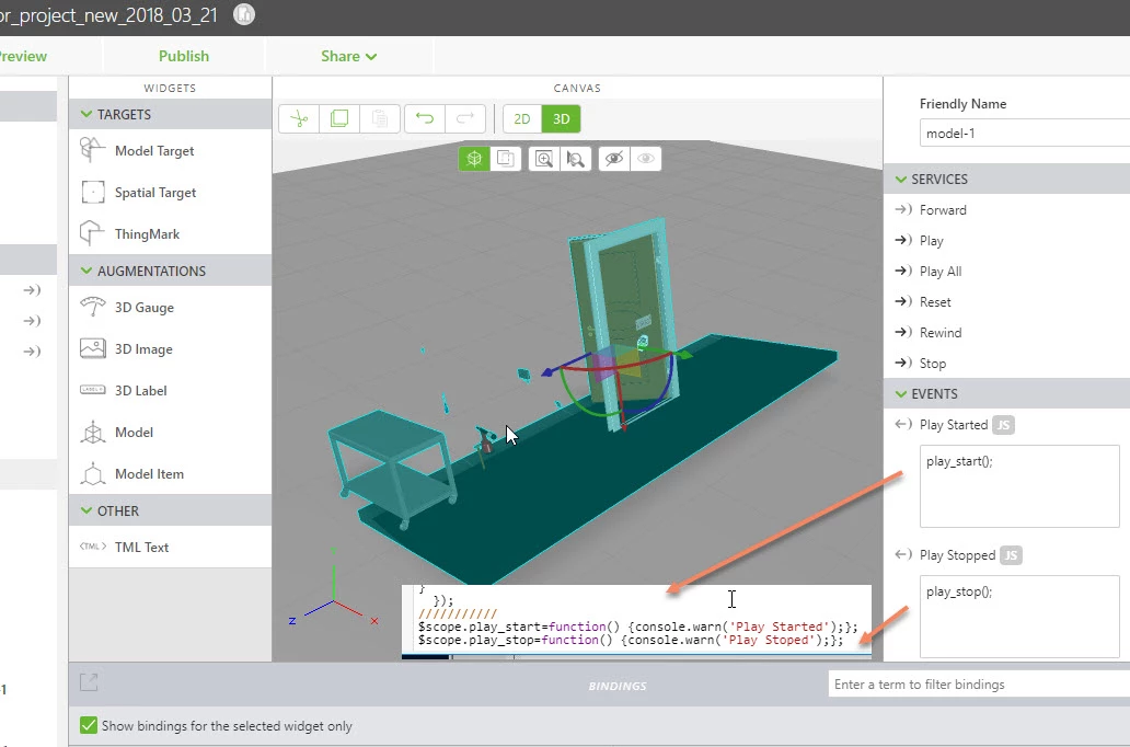

I think you can use the 'Play stoped' event in combination with the $scope.$on('newStep', function(evt,arg) {... event.
I tested the play stoped event and have the follow behavior:
-Now I tested the model. play  service:
and had one start and one stop event (printing of the console.warn() funciton)

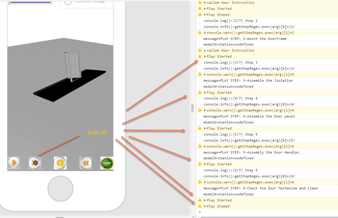

When I tested then play all I had:
so my observations here  are that it started for each step a "play started" event and only on finish of the sequence called the "play stoped" event.  Here I started play All from the step 3.
So means the solution could be to check the current step and depending on it - if it is the last (number) step - in this case we can interpret the finish event as finish of the sequence.
