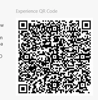

Here a published , public Vuforia Studio demo project if you want to test . I published on my server. If you need to use in your enviroment you need to create  thing from FileRepository template named "CADtestFileRep1" and create there a folder /CSV .Also set the permission for Experience Service according to :
https://support.ptc.com/help/vuforia/studio/en/#page/Studio_Help_Center%2FGrantUserPermissions.html
https://support.ptc.com/help/vuforia/studio/en/#page/Studio_Help_Center%2FAnonymousAccess.html%23
here to test
