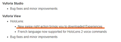

I am using Hololens II and have trying the previously new feature which is download experience.
I able to download experience and view the downloaded experience thanks to the nice documentation below.
http://support.ptc.com/help/vuforia/studio/en/index.html#page/Studio_Help_Center/EyewearViewAndHololens.html
However, for some projects it return "download experience failed" and I noticed that the failed download experience have more than 10MB file size. Just would like to know if there are limitations for experience download.

Jul 20, 2021 8:53 AM UTC
I saw a customer download more than 500Mb experience.
For your case, it seems that you are using a trial version and the below path does not exist anymore.
2021-07-16T14:47:23.799+08:00 [Error] offlinedownload - Error in DownloadExperienceOperation for "create baseUri https://6bbeb72ff4aec16a.studio-trial.vuforia.io/ExperienceService/content/projects/incmodel/, entrypoint index.html?expId=1 and zipUri https://6bbeb72ff4aec16a.studio-trial.vuforia.io/ExperienceService/content/projects/incmodel/"
System.IO.DirectoryNotFoundException: Could not find a part of the path 'C:\Data\Users\shasikumar.dawarajan@gmail.com\AppData\Local\Packages\9CAFC431.ThingWorxViewforHololens_fvvfpfxfdh1zr\LocalState\oe\dp\c31e67f2-2b3e-4b3a-91ba-333dc2722a1e\app\resources\_generated_\mtg\a6fa4794-b68d-4b17-a909-cd5095a57f3c_a6fa4794-b68d-4b17-a909-cd5095a57f3c.png'.

Sep 16, 2021 12:26 PM UTC
Hi @Jimwang ,
We just bought Vuforia Studio and tried offline viewing, but still if fail to download.
