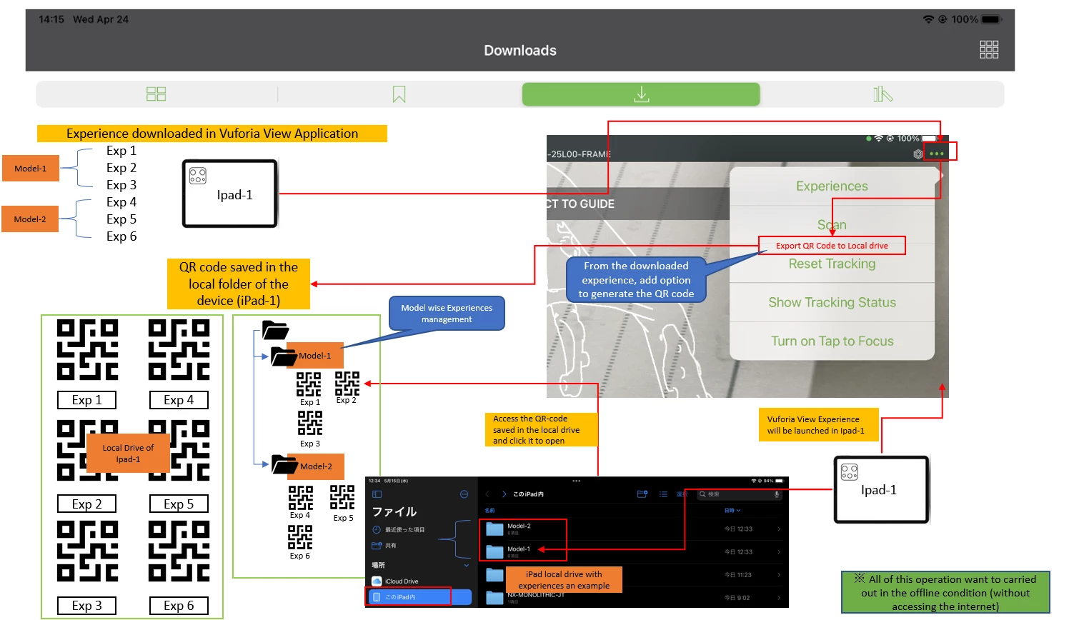

Dear Community Members,
We are aiming to manage experiences on iPad devices locally. To achieve this, we wish to download the experience (QR code) from the Vuforia View application and save it to the iPad's local storage. Our plan is to organize the experiences by model, creating a separate folder for each one and storing the corresponding downloaded experiences within.
Furthermore, we intend to access these experiences offline by simply tapping on the saved QR codes in their respective folders.
Please refer to the attached document for more details. This functionality is crucial, as we are currently facing challenges to find out the necessary experience from the Vuforia View application, especially as the list of downloaded models grows larger each day.
Thank you for your attention to this matter.
Best regards,
Sandy

Hi @Sandy_Gunner ,
I reported this as enhancement request to PTC Product Managment as Jira VTS-2001. I will track the ticket and will let you know in this topic  when there are feedbacks from PM /Vuforia Developement team. Thanks
