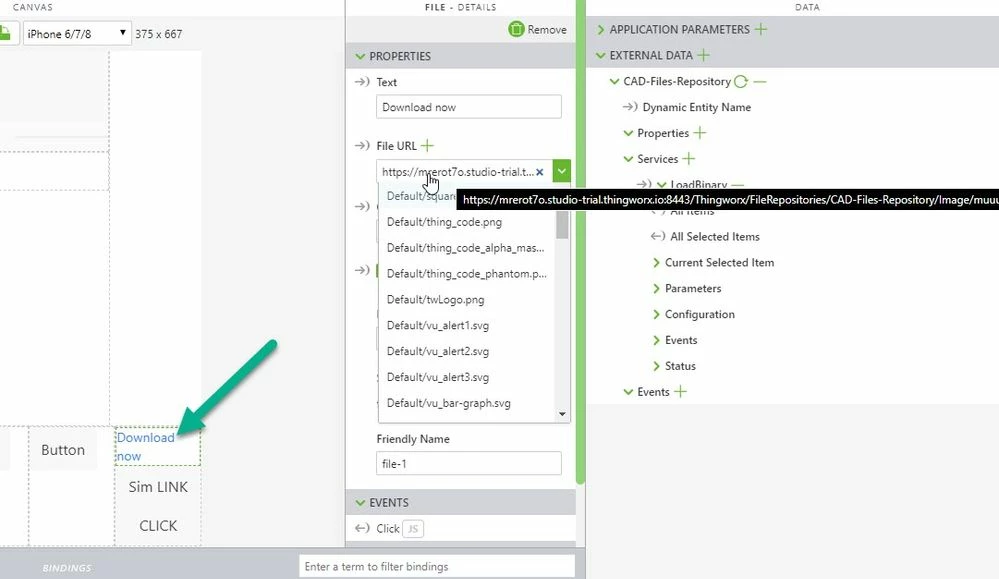

Therefore I tried to follow another approach using a file widget and trying to simulate a click event:
The File Widget - File URL points to the repository location. Then  calling the folliwng script:

this will start a downlaod of the specified File URL
I tested it in Preview and on IOS i-Pad 6 and this worked ok in current version. But on IOS it asks for credential

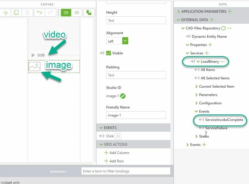

I used the described technique for direct display in Vuforia Studio/view. So the data was received in memory in a session variable
Important are also 2 things:
- to add the method LoadBinary (respectively LoadImage) for the particular repository thing in your external data
- to set the permission (service execute) for the service (e.g. LoadBinary) for specific user or respectively for the  es-public-access.
Why do you to download this file? Do you want to open (let say a particular picture )  file in an external application outside Vuforia view?

For example I have  here a simple project with 2d canvas with 2 widgets:
1.)2D video  Widget : "video-1"
2.) 2d Image Widget: "image-1"
The used the following javaScript definition for functions:

Here I used the TWX service 'app.mdl.CAD-Files-Repository.svc.LoadBinary' to load both image, or binary - this is the  more generic service  (for picture we have also LoadImage with also the corresponding -complete event)
In the service call in the function s. GetImageFromTwxRepository or  GetVideoFromTwxRepository the code will call the service LoadBinary and will pass a path argument.
When the service is completed Vuforia Studio/View will call the 'LoadBinary-Complete" event. In this event  the received data will be set  to image or video widgets. I used variable to make difference between the current call.  But this could be sometime disadvantageous - because the call is asynchronous and  there could be a problem  when we call the functions for different types successive without delay  (e.g. video und image) . There is definitely a better solution where we can synchronize - but here it should display only the general principle  (e.g. one possible solution is to use the LoadImage service and the corresponding event LoadImage-complete)
