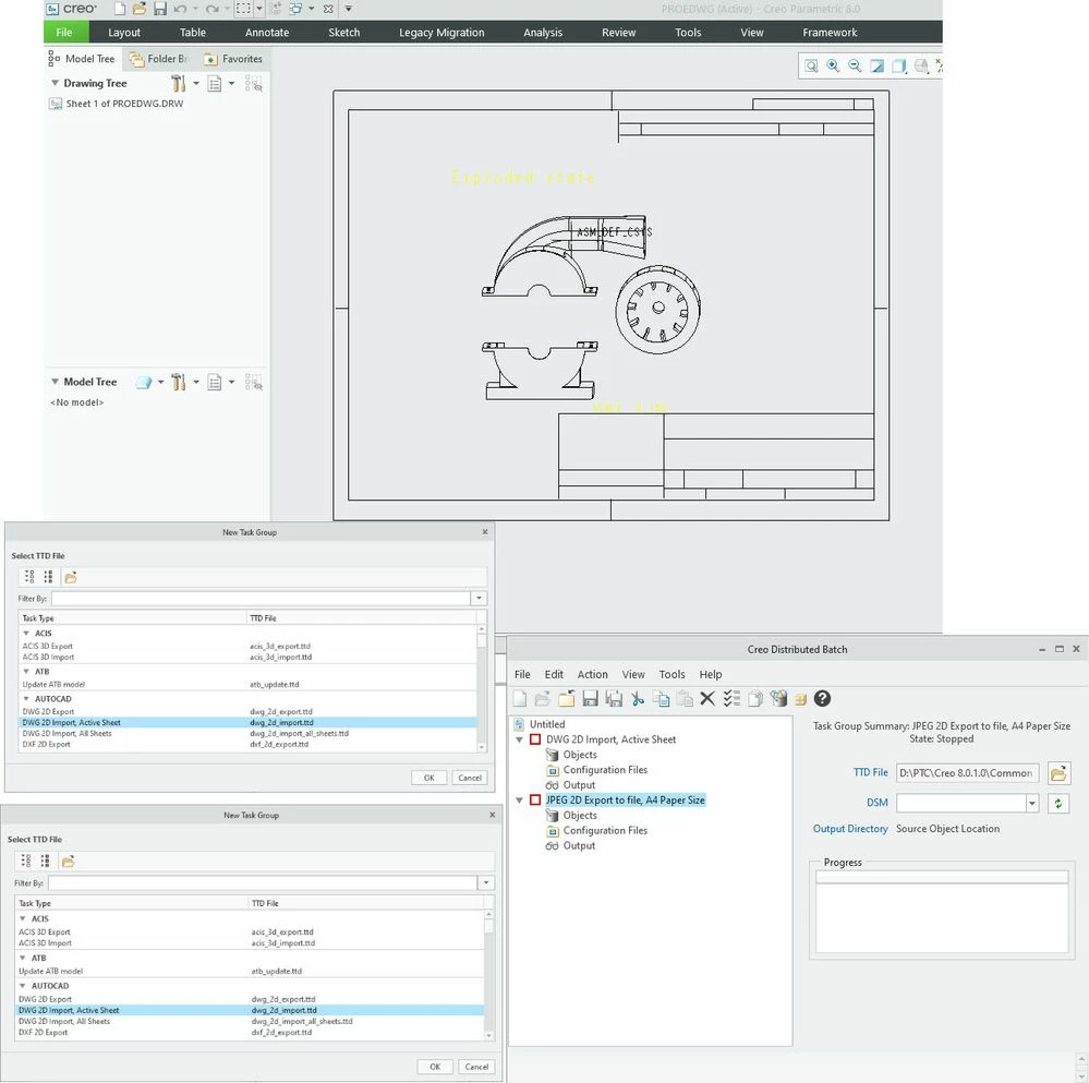

Depending on your environment if you have e.g.  Creo Parametric so you can import a dwg file in Creo and then print it to pdf or to picture format. This could be automated with e.g. JLink or Creo Toolkit . But you can also try to use also Creo Distributed Batch if you need to do this for many files. I tested it and importing of dwg and saving to picture is very easy and in dbatch mode you can call this  e.g. for all file in specific directory (many hundred  files).
