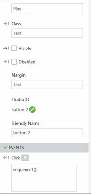

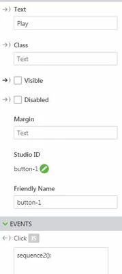

  • In both the Button properties:
    • UnCheck the Visible property .
    • Click on JS next to click event and call the functions as shown below:

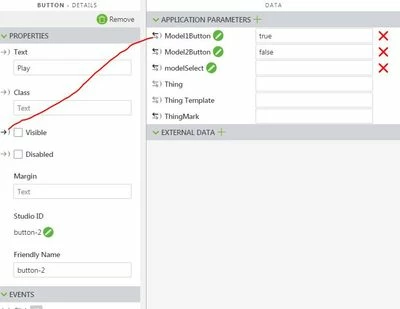

  • In the Data panel, add 2 application parameters. For example, add Model1Button and set it's value to true and add Model2Button and set it's value to false.
  • Drag the binding icon infront of Model1Button and drop it on the visible propert of Button 1.
  • Similarly, drag the binding icon infront of Model2Button and drop it on the visible propert of Button 2.

    $scope.sequence1 = function() {
    $scope.view.wdg['model-1']['sequence'] = 'l-Creo 3D - Disassembly-Sequence.pvi';
    angular.element(document.getElementById('model-1')).scope().playAll();
    $scope.app.params.Model1Button = false;
    $scope.app.params.Model2Button = true;
    $scope.sequence2 = function() {
    $scope.view.wdg['model-1']['sequence'] = 'teardown.pvi';
    $scope.app.params.Model1Button = true
    $scope.app.params.Model2Button = false
  • Save and test the experience.
