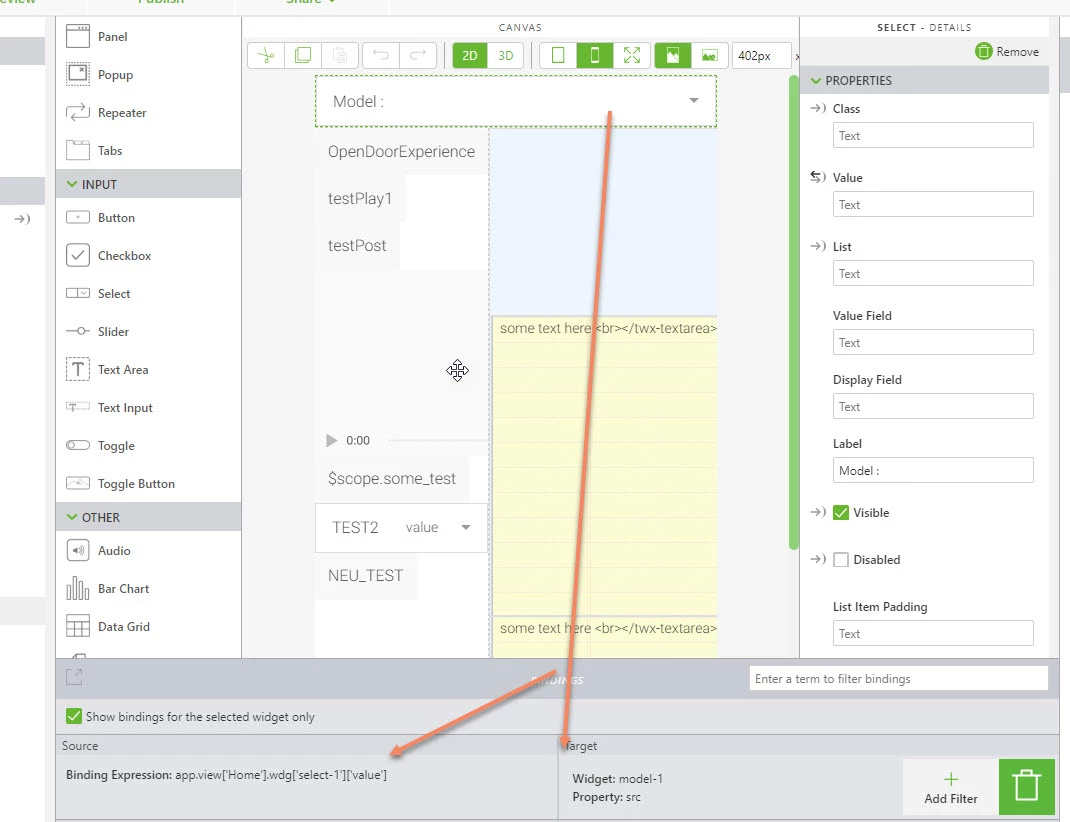

So I could now manually select  the value in the list element -  this action which change the value. I set the binding of the select-1 widget to the model source that when I change the value in the list it will change the source of the model-1
