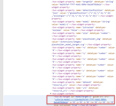

  • In Project, with a Model Target with an empty 3D Model :
We have in the Model Target object, these settings.

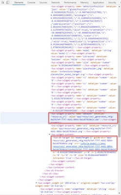

  • In the same Project but with a 3D Model and a Target Model, we have :
  • We can see :
  1. A .dat file is used, in twx-widget-property  name="dataset" tag. By the way, I have checked locally in Project folder, I was not able to find this .dat file.
  2. A png file file is also generated, in twx-widget-property name="url" tag. This file is present locally in Project folder.
  3. Other tags have been modified also, as in twx-widget-property  name="detectionPosition" tag. It seems just information about location of Camera and 3D Model when Model Target has been generated.
So, I presume to have something who might work ; it is needed to update these settings with a custom Javascript.
