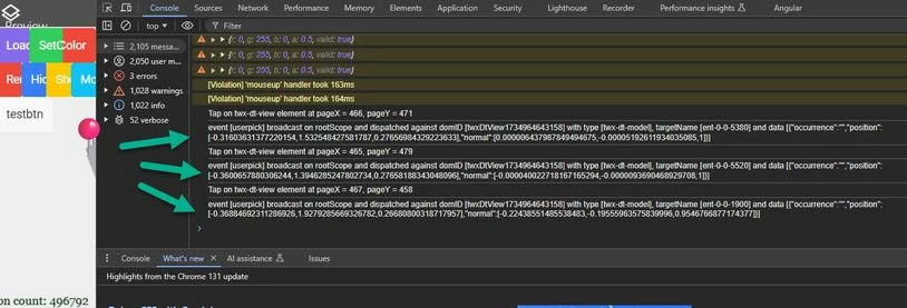

-now tetested - yes they can be identfied by userpick, e.g.
