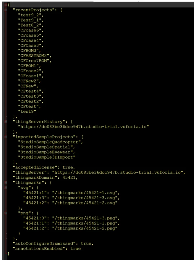

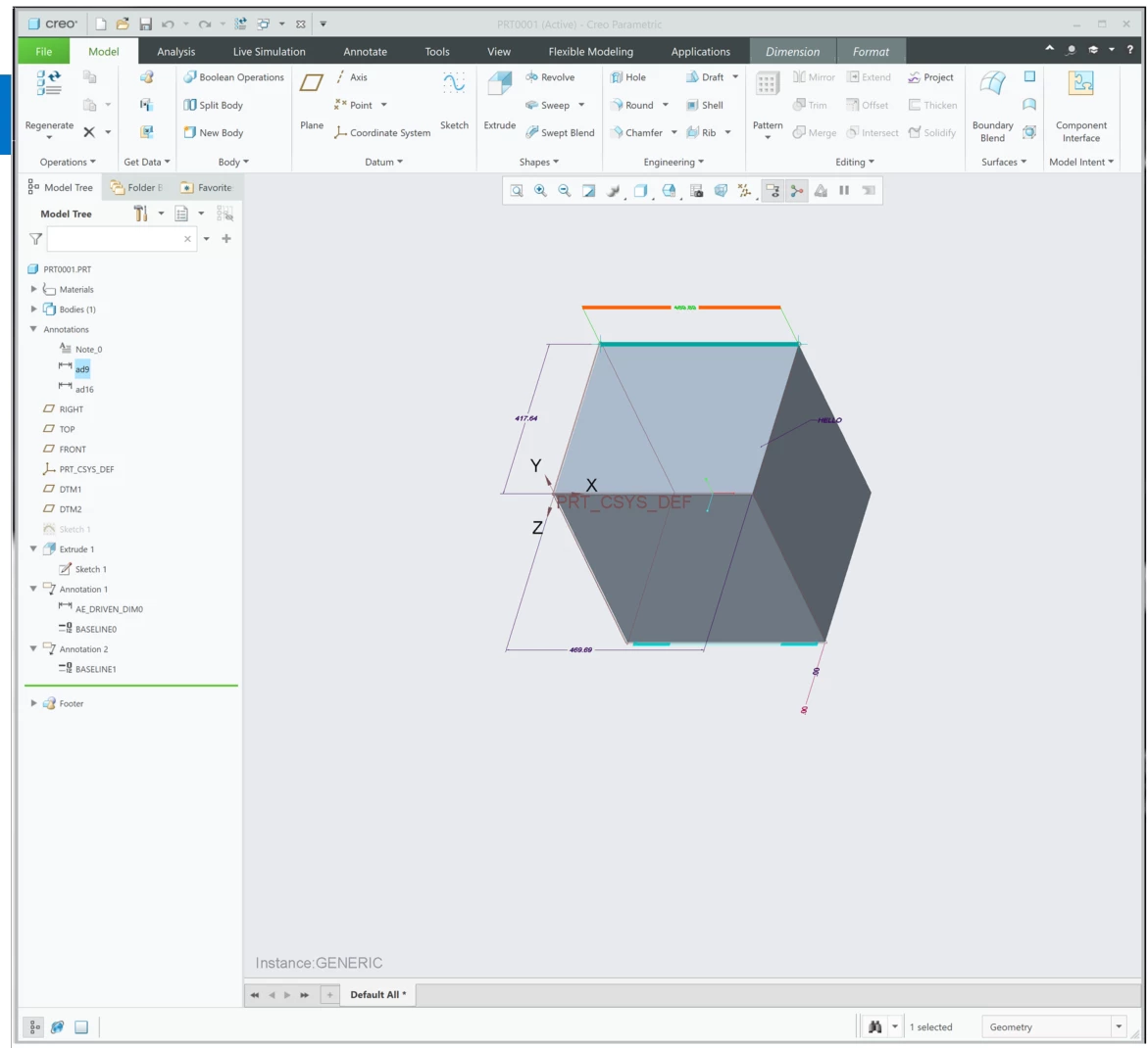

This is a screenshot of the part with annotations I made in Creo7.0 and the modified "builder-settings.json" file.  I can also send .prt & .pvz files.  I used the trial version of Vuforia.  I am not able to get the annotations to appear in the Vuforia experience.
Scott

Hi @sobrien-2_53235 ,
what is the EDM source CAD system ? e.g. Creo Parametric?
If yes ->in this case you can check this post : "Annotations from a model 3D in an AR project"
e.g. the setting of the  builder-setting.json option: "annotationsEnabled": true
in your Vuforia Studio installation which is located in< users/documents>\VuforiaStudio
open the file builder-settings.json for editing (please, first save a backup)
add the option (note: so far I know this option is not official supported yet
->"annotationsEnabled": true
->restart Studio and import the model to the resource folder.

-actually in the current functionality, so far I know,  the annotation(e.g. dimension) will be not shown in Vuforia Studio – so at least this is not official supported.
-my observation was in the past that when I export a model from Creo Parametric to PVZ file and  in the Creo Parametric I have a combined view with shown annotations in Creo Parametric – then in this case e.g. the shown dimensions  could be also displayed in Vuforia Studio via the option (annotationsEnabled": true is added to builder-settings.json,). The requirement is that the e.g. dimension annotations are created and shown in a combo view when you exported to PVZ
