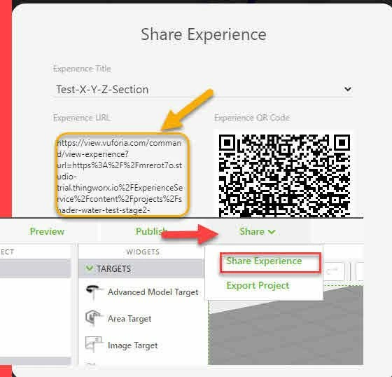

Hello, I was wondering if it is possible to embed a vuforia studio project into an existing app. Either by web or even directly.
My idea is that I have an existing application, make a vuforia studio project, and in the application, when I click on a button to see in augmented reality the project opens inside that application. and have the experience inside that application.
October 27, 2021
Hi @RG_10041320 ,
depending on the goal of the embed view we can:
  • another option is to call form you application the Vuforia view app. This will work when you app has the permission to call another app. On the device is a Vuforia View app installed. In this case you can try in your own app to call the url - the deep link which you could see in the share Tab- share experience:
e.g. here your app could call window.location or window.lcation.href   = url  e.g.:
