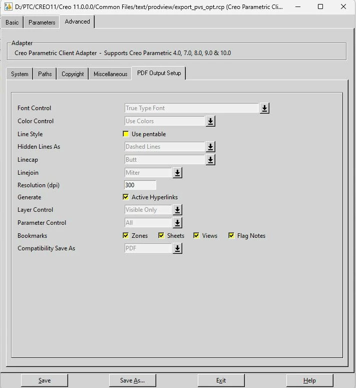

For example if you have installed the rcp editor  - rcpedit app - is part of the Creo View adapter package /not part of the Vuforia Studio Product/
Here is an example of rcp edit (here for PDF export) where we can specify a layer filter. So the principle for PVZ is the same but the correct filter should be applied. How to set this import filters - means the setting of the rcp options - this   needs to be clarifed with the TC Macad Adapter Tech Support Team.

2. Consider configuring step2pv_import3d_dt.rcp to include layer info into converted PVZ files
We've managed to import layer info to Creo Illustrate, but Vuforia Studio cannot recognize layer info no matter if we import directly into Vuforia, or via Creo/other adapters.
We've also asked PTC support for the solutions as you've suggested, but they also said that's not possible.
