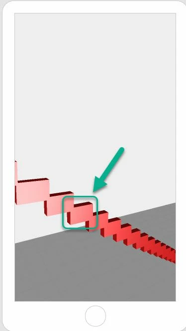

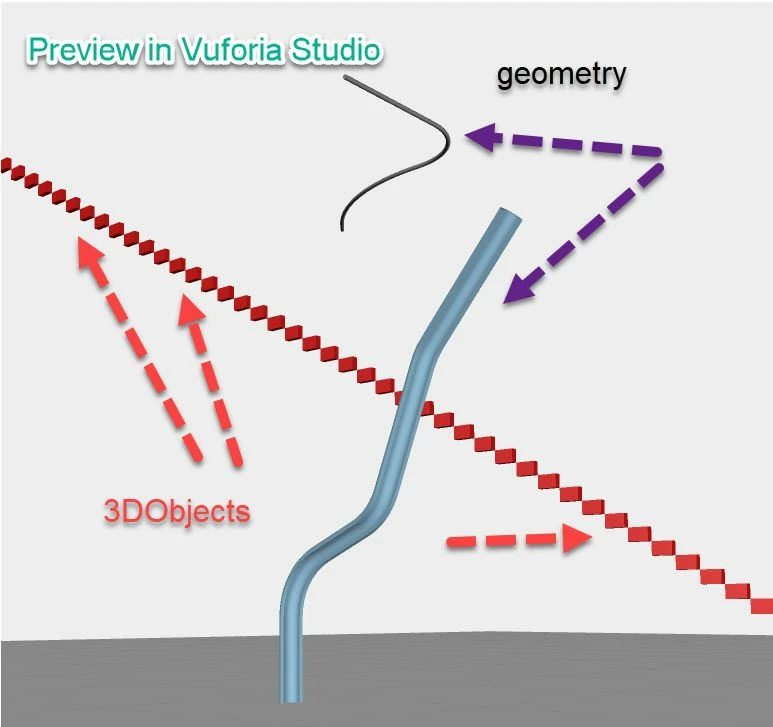

This code above is only an example what I tested and therefore could confirm that it works but want to mentioned here that  it is not the best programming style e.g. for implementing  here using   many cuboids - shown on the picture
So regarding to the curv creation - as it is currently not possible and it is not supported by the PVZ format - so you could use this workaround to create you curv from many points (e.g. cuboids) . There is a simple implmentation of line shown

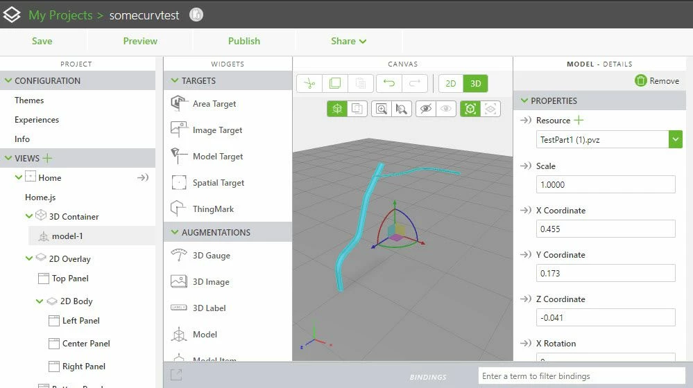

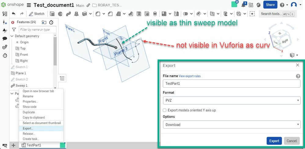

So what I think could be  better - you can create insead of curvs a small d3Sweeps - pipes which are displayed in Vuforia Studio example:
so model in onShape but this works also in Creo Parametric. And then export pvz :
And in preview:

I have a query related to the cuboid placement to draw the curve. Can it be useful to draw a curve which isn't straight ? In attached figure, the created curve seems to be a straight curve.
