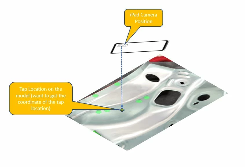

Hi Community member,
As of now, there is no functionality to get the coordinate of the tap location in vuforia view.
In unity , it seems that the coordinate of the point in the direction of the ray can be obtained with the API Physics.Raycast. See the link for your reference.
https://docs.unity3d.com/ScriptReference/Physics.Raycast.html
I am wondering whether similar concept can be implemented in vuforia to get the coordinate of the tap location.
Please see the sample image of the expected functionality in vuforia view.
If AR use predominately for marking the critical location (model tracking experience), getting the coordinate of the marked location is mandatory for the verification. If you have any idea/suggestions to get the coordinate of the tap location in vuforia view, please feel free to share. If this functionality available in vuforia view , it will greatly help to enhance the quality of the manufactured goods.

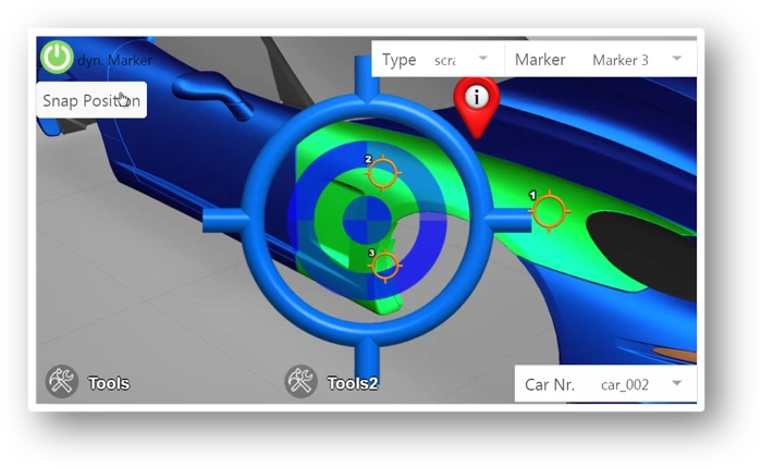

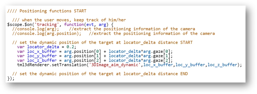

We have another workaround: Basic principle of my/this workaround: Dynamically Extracting the camera - and calculating the ‘Target Crosshair’- Position  --->   $scope.$on(‘tracking’, function(evt, arg) Picture1.png
  • At any moment in time XYZ-position and orientation of the device camera relative to Experience-origin is extracted
    The blue crosshair image is constantly calculated to float (billboarded) at 20cm distance in front of the camera
    The constant re-calculating of positioning needed for this method is a performance/battery-life killerPicture2.png
