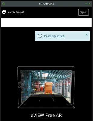

We are using ePlan eView to display 3D panels in AR. We recently acquired a HoloLens 2 as it was mentioned on Vuforia's support page that this was supported and that Vuforia View could be installed on it.
The issue we are having is that when you scan a QR code from ePlan eView, it then takes you to a log in page.
This works fine in mobile devices, but the login page does not load in the HoloLens Vuforia View app.
None of the content other than the white bar shows in the Vuforia View app in the HoloLens.
Because I can't log in to eView, I can't load the model. What can I do???? I need to get this working.
