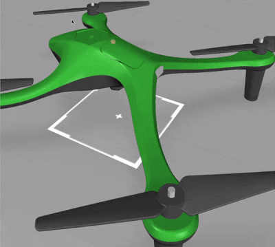

Apr 9, 2021 3:35 AM UTC
The effect is done by Javascript in Vuforia Studio.
I guess it would be possible to change the scale simultaneously, but haven't found out how.
