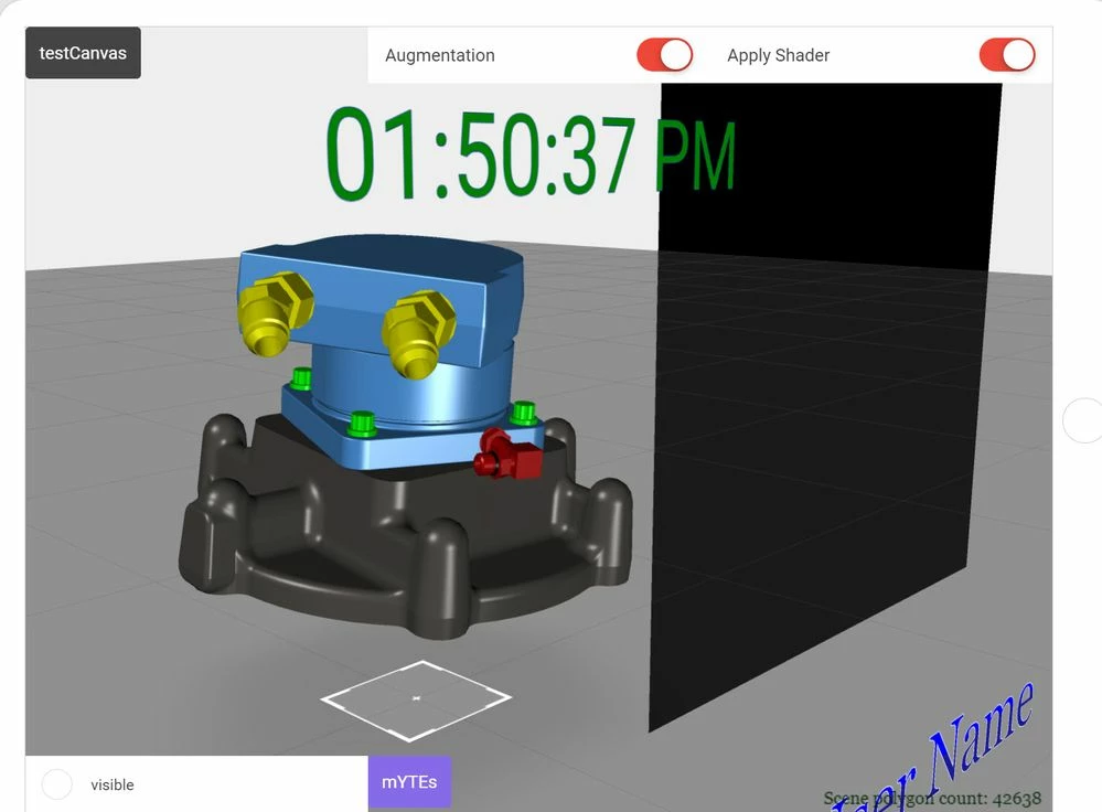

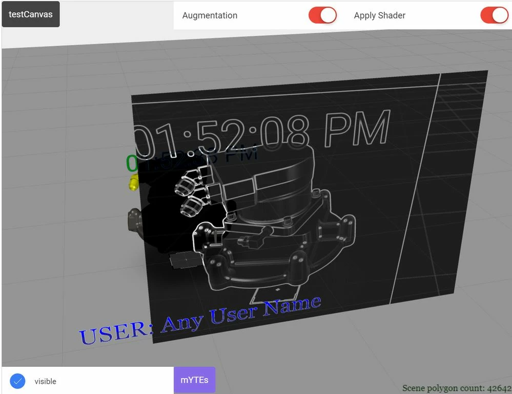

So regarding possible workaround - we can take a picture (or possibly 2 pictures - one time without augmentation and one time without augmentation) and sent to server - where we have a picture analyzing system where you check that.
For example you can use some kind of soebel filter
to have only edge display  (grdient x,y) to get something like this:
and then you can use some image recognition network which is trained to recongize the hole geometry . Possibly you can compare the 2 pictures (with/wuthout agumentation) both as edge geometry) to find where is a difference.
