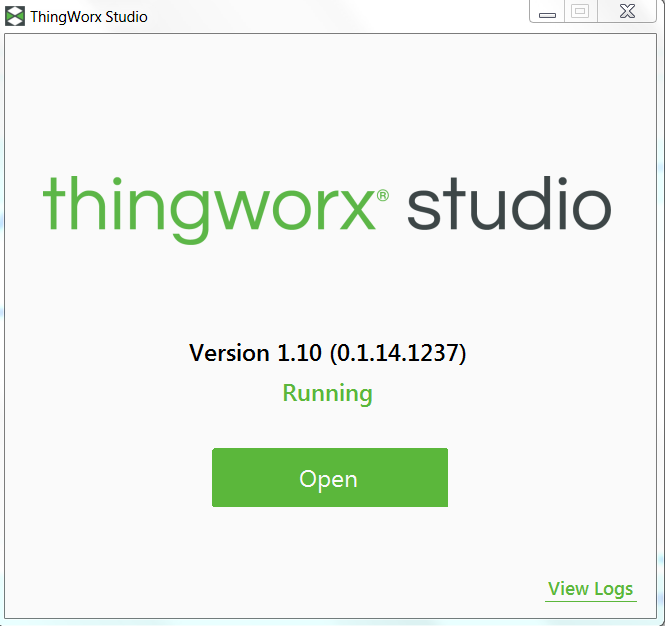

The logs are accessible from the ThingWorx Studio application window. You will find 'View Logs' link on the bottom-right of the window.

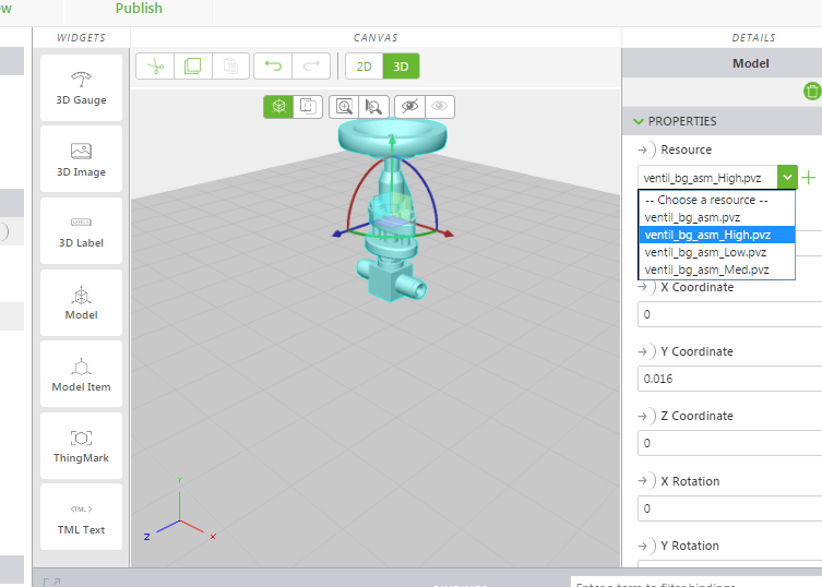

I tested also the issue with Thingworx - version:
Created a simple file form Creo Parametric model and exported it to step
And added to resources in Thingworx 'Studio. I selected the option optimize. So the results is that it created pvz models with high low and medium .
So I believe may be you need to check the step file if it is ok and could be retrieved in any other tools - for example in PTC Creo Prametric. I used for the test Creo Parametric 4.0 M010
