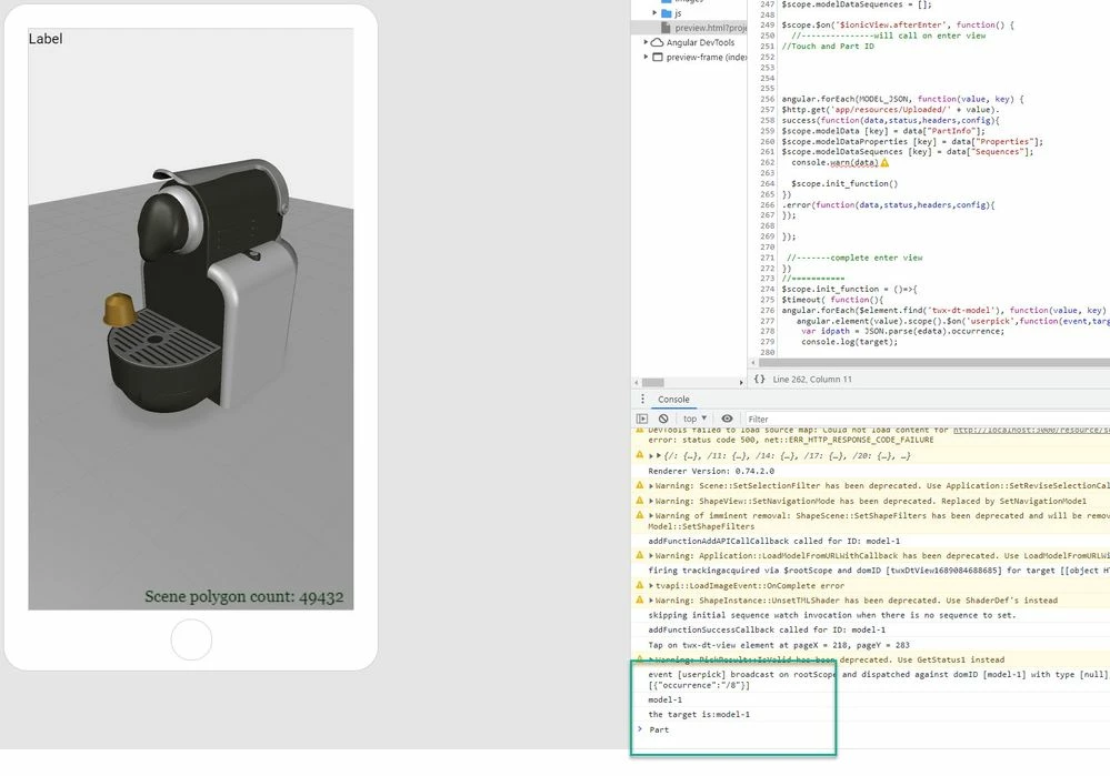

Hi @JR_10569306 ,
in the code you provided there is no error- it work in preview, not that what is possibly intended but there is no error.
So to test this issue I believe further data is required.
e.g. the CoffeeMaker.json file and the pvz model. I believe there a PTC model with similar name but I could not find exactly the same name. I found the the following (attached version of coffemaker - in the attached upload zip with the metadata json, but It seems that it is not suitable to the code- so int the extracted metadata there are not properties like "PartInfo"
Therefore to be able to test the code , we need the model and the json file which should be loaded from the upload project folder.
But what I could mention there   is that there are no syntax error in the code. Possibly there is some data corruption in your project.
You can create a new project and test when there is no error (so means your Studio installation is OK) then you can try then to replace the Home.js and Home.json in the project  and try open the project again if there is an issue.
What is the Studio version what you use- is the last one. Possibly you updated to 9.12 and then try to open with 9.10 - then this will not work there are several errors.
Also when I do import the code incompletely in a new proejct  - so still the userpick is working in this case:
