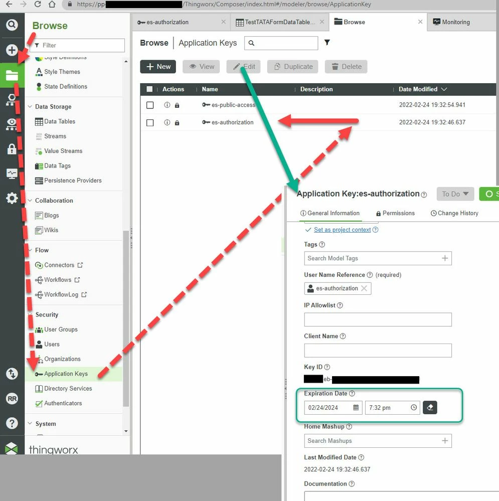

Error:" Uh-oh! Publish Failed. Permissions denied uploading the project"
Hi there!
I have been trying to post a sample project and the following error comes: Uh-oh! Publish Failed. Permissions denied uploading the project"
I already followed this step-by-step (https://www.ptc.com/en/support/article/CS268110).
The users I´ve been using are all under Developers group  and have Read Permissions for Resources Collection in Design Time. I also tried using the Admin and it also didn´t work. This users were created 2 years ago and used to work.
Can somebody help me?
Best Regards!
Teresa

you can check this on the  Thingworx instance:
Jun 7, 2022 1:06 PM UTC
Hi @TeresaVR ,
when it was working in the past then the following possible action:
1.) please, check if the appkey for the user es_authorization and es-public are still valid / not expired . If expired set to valid expired day
2.) also you can check the configuration.json on the ES side if it used the correct appkey / default es-authorization . If other appkey is used then check if it is valid

thanks for replying. Now where can I check that? I just found this article https://www.ptc.com/en/support/article/cs299582?language=en&posno=2&q=es-authorization%20appkey&source=search. It doesn´t state where exactly to find it and I have no idea where the appkey is.
Jun 7, 2022 1:34 PM UTC
